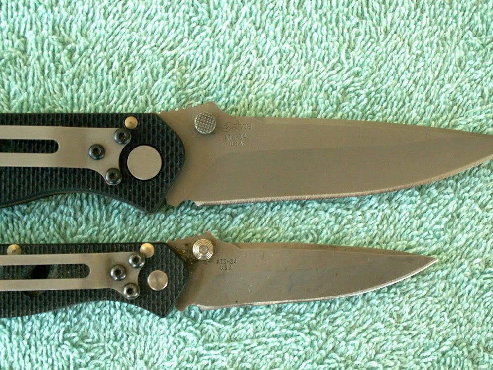

Good question. Here's two Taclites, one with the Bos stamp and one without. I believe that they were only made in 2001 and 2002.
Just curious as when they started using the bos logo on the premium steels. My odyssey is 2001 and no logo. Just wondering.
