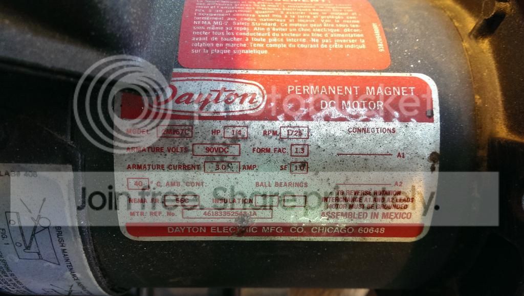

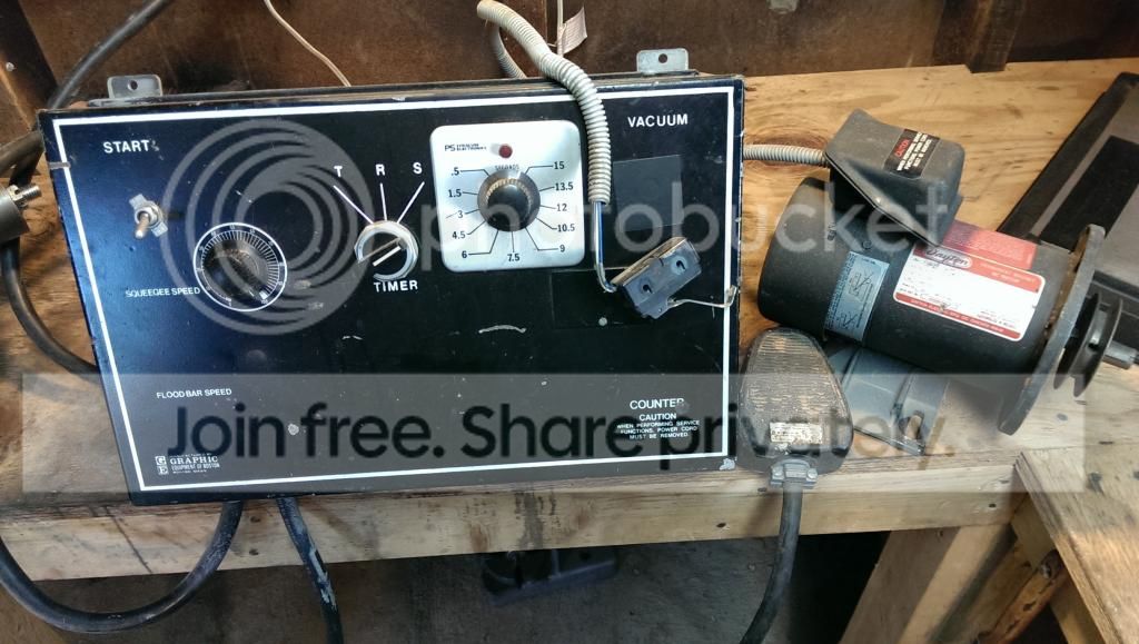

A friend of mine gave me this DC motor and speed controller thingy. He said it came off of his family's t-shirt screen printing set-up and that I could have it if I wanted it. Naturally I took it, as it works perfectly fine. The big box has a "speed control" and it even came with a foot switch and another micro switch that will stop the motor when held down. Anyhow, I've been thinking about some way to put it to use in the shop. Since I don't currently have a buffer, could I use this set-up for that? I realize it wouldn't be the ideal buffer, but if I could use it for that purpose, it would be great. If so, what exactly would I need for the output shaft on the motor to connect a buffing wheel? Thanks for your input fellas.

but at 1/4 HP, I'm not sure what it's good for.

That's the thing Count, I can't think of anything other than a buffer that it would be adequate for given the low hp. I did find what I was looking for at K&G.
http://www.knifeandgun.com/SearchResults.asp?Cat=60
The investment would be minimal to set it up as a buffer, so I think that's what I'm going to do. The variable speed functionality may never get used at all, but it's already wired up for this set-up so I'm just gonna roll with it. All I would currently need to use it for, is to give a light buff to handles. Should work well for that I hope.
I have a similar set up with a buff on one end and a chuck with all sorts of sanding drums for that end. The variable speed is more useful in that capacity, but no need for two chucks, so a smaller buffing wheel found it's way there.
A double end mandrel with a pulley in the center driven by that motor would throw 4" to 6" buffing wheels. It could be slowed down nicely for delicate handles.
After thinking about this for a bit, I think I'm going to go with Stacy's suggestion. I like that it would allow me to have 2 buffs instead of just one. The biggest thing though, is the clearance around the buff. I would need at least an 8" buff if I attached directly to the motor to have any clearance, and it would still be minimal clearance at that. With 6" buffs on the mandrel set-up, I should have reasonable clearance around the buffs for handles. I don't know why I didn't think of that before, but thanks for suggesting that Stacy.
