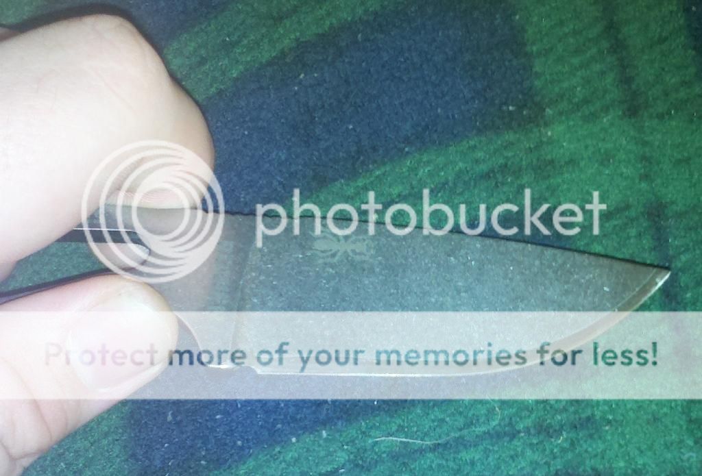

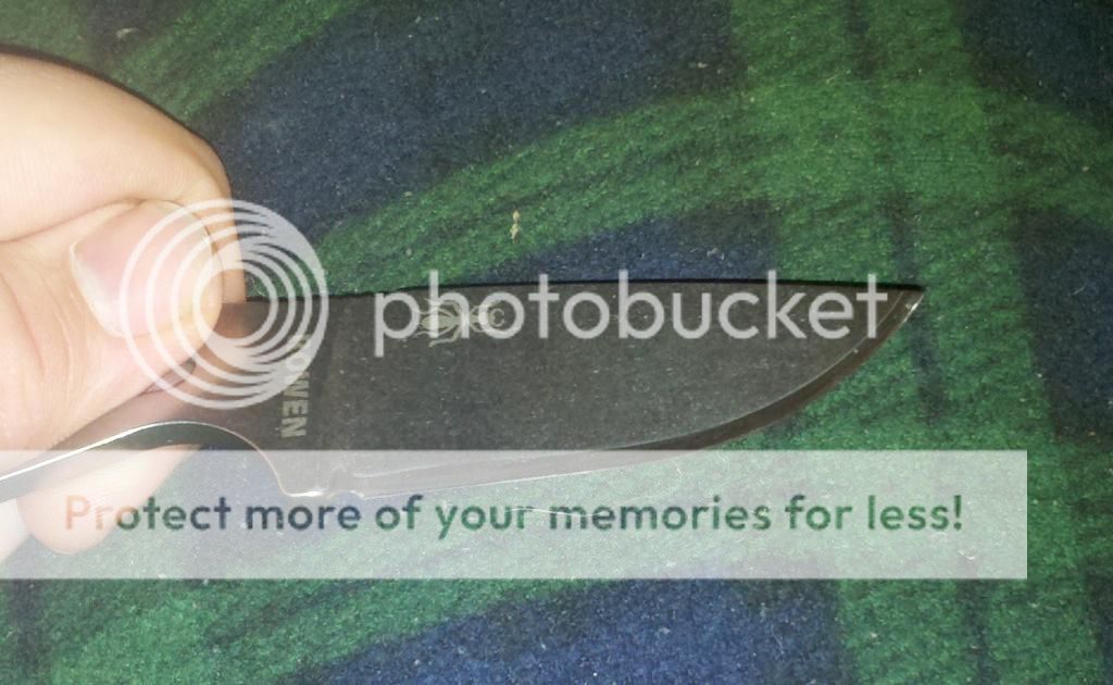

This happens to me a lot. Ever conceivable way I have for measuring the angle tells me that I've kept the same edge angle, but I still wind up with uneven bevel width, and usually it's narrower at the tip.
Is it possible to just have not ground enough metal at the tip to have got the bevel the same width as the rest of the blade, even though the angle is the same?
Near the heel it looks MUCH wider and I know it's because I accidentally held the angle too low at one point, you can kind of see the curvature in it too. But that just makes me think that the bevel width isdependent on the angle so maybe the angle at the tip IS different? I've got angle wedges to check against, I know the trigonometry and I've got Fred Rowe's ERU to use as an angle gauge and they all say the angle is the same at the tip... So why the uneven bevel?
My theory is that I've just removed more metal from the flat portion of the blade near the heel because it's flat and I can keep most of that area in contact with the stone as I grind. When the belly and the curve starts, I have to work more to lift the pommel to follow the curvature of the blade, but this is a lot more cumbersome and not nearly as fast as it is at the heel so I tend to kind of stop when it's "good enough" even though the bevel widths are different.
It's no big deal but something that bothers me because sometimes it happens and sometimes it doesn't, and I just want to know if it's a matter of not putting in enough work--ie not evening it out all the way along the edge--or if the angle is off. But if it's the latter, it's certainly by no amount that I can verify so it doesn't seem significant. It occured to me that since it was at the belly and I have to lift the pommel maybe it was just a slight variation in angle, but I've sharpened other knives with large bellies and had no problem keeping the bevel even so... It just seems random whether this will happen or not, but I have noticed it happens more when I sharpen an Izula than other knives.
Could the fact that the blade stock itself ( i.e. thickness of the blade ) narrows as it nears the tip have something to do with it too? Since it's thicker at the heel, there's more metal to remove to get it to the specific angle than there is further up toward the tip. So it would make sense that the bevel formed would be "wider" at the heel since it had to transect more metal. But here's the problem with that... I see plenty of other Izula edges that are uniform bevel width all the way through, and plenty other knives with distal tapers that have even bevel width as well... So I'm not really sure that has anything to do with it.

It's a 22 degree inclusive bevel with a 30 degree inclusive microbevel--looks like a burr thanks to my crappy camera.

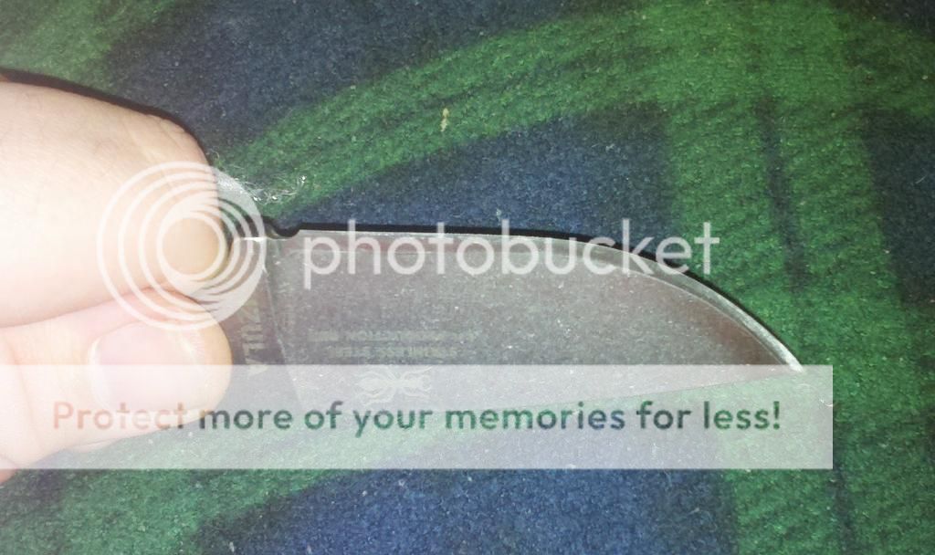

Edit:
Added more pics 'cause the lighting makes it hard to notice what I'm talking about
Thickness of the steel at (or just immediately behind) the edge makes the biggest difference, assuming the angle is actually remaining constant (and that's difficult to do, especially freehand). At a given fixed angle, the bevels will be wider in thicker steel, and narrower in thinner steel. If the blade tapers from heel to tip (called a distal taper), the thinner steel at the tip will most influence the appearance (width) of the bevels there. Blades with less of a taper (in thickness) from heel to tip will sometimes show a WIDER bevel near the tip, because the cutting edge at the tip is closer to the thicker steel near the spine of the blade.

From the pics it looks like you might be dropping the handle low off the edge of the stone or some similar mechanical defect. It really helps to keep the fingertips of the offhand exactly where you are grinding. I used to have a similar effect plague me when I become inattentive on the left side of the blade right at the ricasso. I ID'd this as being a poor contact zone for those offhand fingertips and mod'd my grip to accommodate better contact - problem solved.
If it only happens on one side of the blade, it is frequently a warp - thicker bevels on either side of a thinning region can indicate a concave warp. Convex warps on the opposite side can sometimes present as a thickening of the bevel but frequently do not present very obviously. The concave warp will always show itself to some degree and con only be eliminated by treating that exact region like a recurve to even the grind out.

I'm not sure what you mean in the first paragraph, do you mean the area of the bevel right in front of the ricasso where it the bevel shoulder very clearly has a bit of a "arch" effect? Because that particular spot was caused by holding the angle too low during the initial grinding phase. The second picture shows the other side (the "Izula" side versus the "Rowen" side) which I didn't mess up on. :P
I'm mostly talking about the effect at the tip, because I'm positive ( well a least as much as one can be freehanding ) that I held the angle at a constant there.

^This is the primary cause of "uneven" or tapering bevel-width while maintaining a consistent angle. :thumbup:
The second most common cause is using a clamp-system like the Lansky or DMT aligner or Wicked-Edge, but that doesn't apply here.
Something to note is that few knives if any are perfectly symmetrical. If you use a guided system it will reveal that asymmetry. To counter it you can sharpen at different angles on each side to maintain the bevel width. Additionally the blade might not be even down it's full length, that is to say the tip is usually a higher angle the the rest of the blade. You would have to sharpen at a higher angle to compensate for this.
