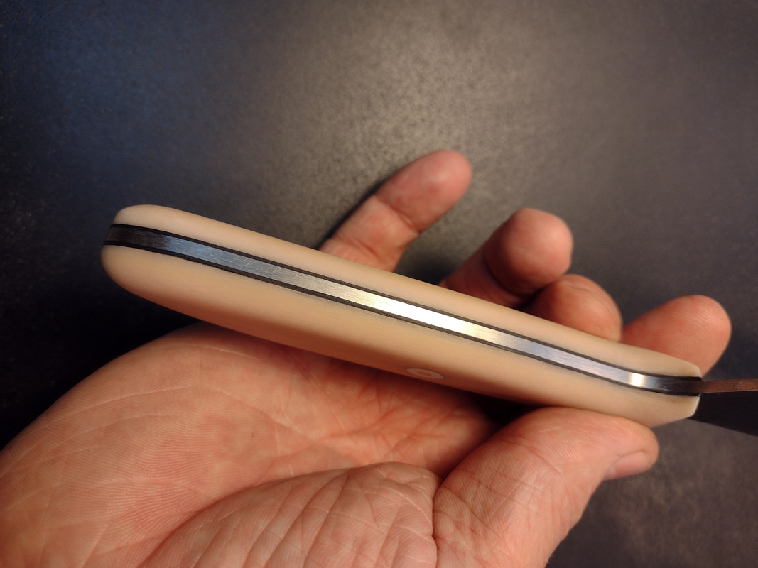

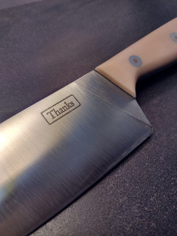

Here's Mine I just finished last weekend. Gave it to my niece as part of a highschool graduation present.....7" Chef's knife. NitroV treated to 64 HRC. Flat/Convex grind, hand ground edge. Linen micarta scales. Handmade bronze and aluminum hardware.

How thick is the blade at the spine?
This batch was kinda thick (0.090" - 0.093")
My next will be a smidge thinner.....
Although, for people who aren't Pro....I feel a bit of beef is more user friendly. More forgiving.
It's a tough line trying to balance, and make Everyone happy.
