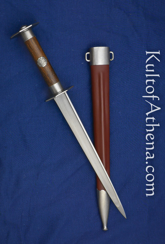

What about this Hanwei Rondel dagger? It's 5160, has 9 inch blade and has a T-shaped design that allows for a strong tip.
A Rondel dagger, tanto or Bowie knife etc are better for knife tasks but a double-edged blade gives you access to certain fighting techniques some of which depending on the situation can be very effective.
