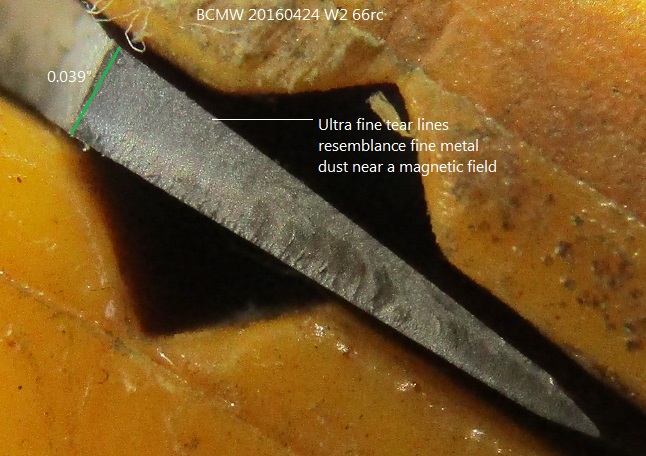

Break a drill bit and try to get your ht to produce a broken surface looks close or better than it.
My ht produces what I called 'interlocking' lattice in ultra fine grain matrix. It's very difficult to take picture to capture surface depth from a head-on view.
When looking at broken surface:
Lumpy spheroid shape = large grain
Glass smooth = fine grain but high in plate martensite %
Teared lines = fine grain and low plate mart% (i.e. good) *note: lath is offset lattice
Like fine cloth teared or fine metal dust in magenetic field = ultra fine grain + very low plate mart% + interlocking lattice.
