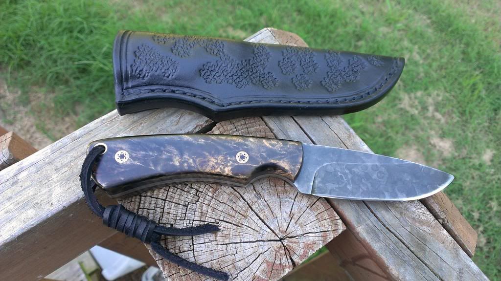

Here are a couple of recent knives using the in-house ground blades from Jantz:
This one is 1095 with a vinegar and mustard patina, maple burl that I dyed and sanded back with a CA finish. My knifedogs KITH entry this year.
This one is bead blasted D2 in stabilized buckeye burl. I donated this one to the local Relay for Life charity auction.
Wow, love those! Especially the 1095. Are you doing the leather work as well? What about the mosaics? Those come from Jantz too? The secondary bevels are really nice and the handles look comfortable.
Yes I hand make and hand sew all my leather sheaths. These mosaics came from Jantz, they are the Gatling style. They are very comfortable...these are my first two that I made using a tapered handle rather than a thinner, rounded handle. I like the tapered.
