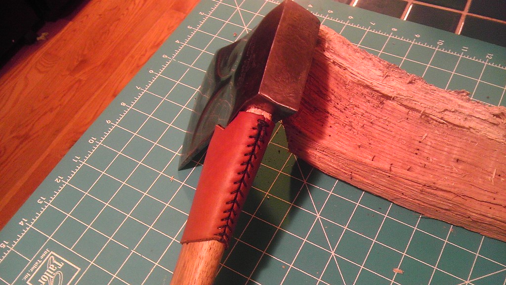

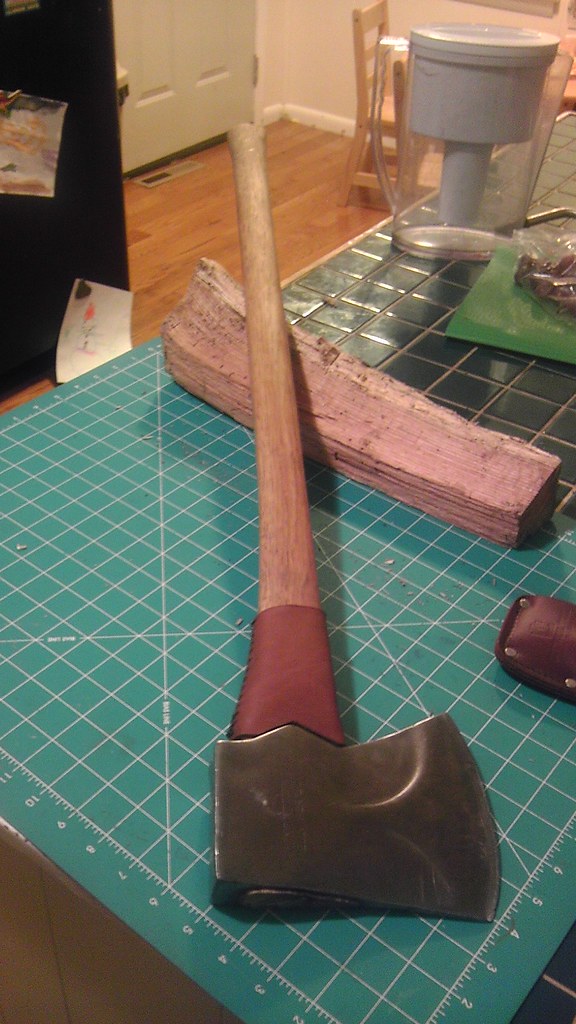

I did this wrap with heavy cow rawhide. Sewing it on wet helps it shrink tight around the shoulder.
