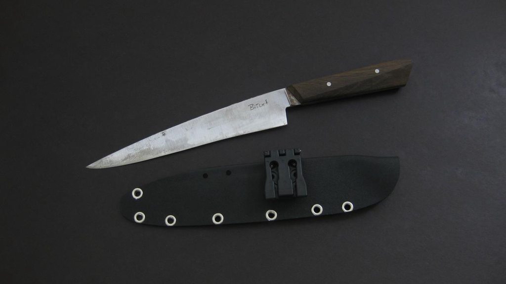

This:
and then I give them to friends or abuse the living hell out of them.
A wise man once said... "Within every 10 inch bowie is a 4 inch skinner."
I make smaller knives our of them. Which explains why all of my knives end up being pocket fixed blades. and if I screw up the finish then it gets a nice patina or etch to cover it and nobody knows.
