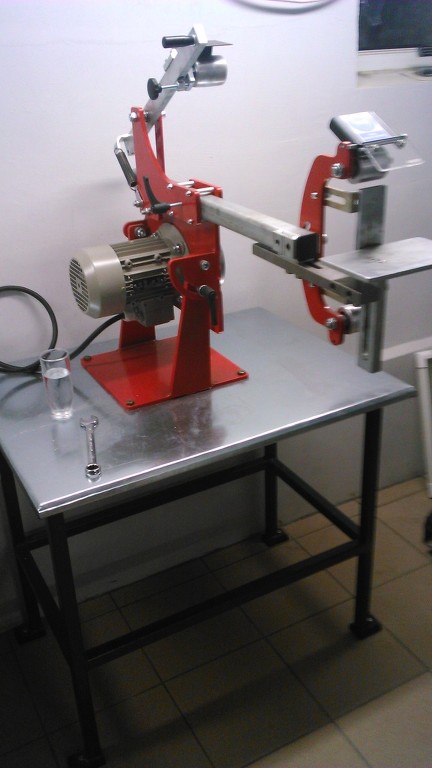

I turn my grinder horizontial when:
- Working with small wheels = better curves on knife
- Making Toxic finish of G10 with 10mm wheel
- Satin finish with Trizact and ScotchBrite belts
And now...
Changing burned Siemens 1.1kW 3phase motor for new... (Error in electric instalation caused burning of engine, now I need take him to rewind coils...)
