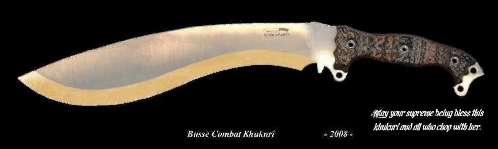

If you prefer the traditional K then stay with the traditional - Knife design is supposed to evolve for changing times. This is Busse's take on the K - I like it and only wish my budget could handle it.
Dont get me wrong, Antonio, I like the flow of the BCK and i like the lines of MOST Busses, but the handles on them and their expensiveness have always been their ugly points for me. I really dislike Tiger stripe Micarta.
I am not saying they should stop, I just think it would be nice to have the option of different handle materials.

Little more curve geometry maybe?; that's what makes it work...
Too much like any other Busse? Brand characteristics can be like seasoning salt; little bit better than a lot. My .000002. :p

That picture is just an idea by someone of what "they" want the Busse Khuk to look like....not the actual one.

My first impression is that the handle is too small for serious chopping. Can't tell for sure, as I'm not certaIn about the scale of the whole knife.
personally, I would like a little more down sweep and a bit more belly, maybe a little more like an M43.

yup, needs a proper cho (kaudi)
minor change, but it ain't a kukhri w/o one.
blessing it is optional but it helps ;)
That's kind of funny, since in the thread on the Busse forum, the guys seem to be trying hard to make a rather traditional kukri. I suggested going with the CG treatment of the multiple ridges on the blade (can't really call them fullers), maybe with some of the spine profile like on the CGFBM or Hellrazor, but that kinda got shot down by guys wanting the traditional look. IMOP if they are going to make a Busse kukri, then make it a Busse kukri, not just another traditional kukri with different steel and micarta scales.
Mulling it over earlier today, I guess I'm actually after more of a Busse Falcata than kukri -- i.e. a fighting blade, not so much a woods tool.
nothing wrong with making it a chiriwa style with grip slabs in whatever shape and material you want, with or without fullers, and nothing wrong with a blade made of a supersteel, forged or laser cut & ground, with or without a guard or lanyard hole, but having the thread posted in a traditional khukuri forum, you are bound to get suggestions on making it look like a more traditional khukuri, it's evolved into it's present 'traditional' form over hundreds of years of survival of the fittest testing in nepal into it's current form. our founder, uncle bill, was the one who stated it isn't a khukuri if it doesn't have a cho. w/o one it's just a KSO*. i also prefer the more curved ones, with more curved hilts, in lieu of the straighter ones we generally see, but to stand out from all the wannabe's, a cho would be nice. you can probably skip the traditional sacrifice of a goat over each batch tho.

I am not surprised at the preference for traditional kukri here, but rather on the Busse forum. Busses are anything but traditionally styled knives. I was a tad bewildered why they would want a traditionally-styled kukri from Busse. I don't mean to be harsh, and I did say most ofm this there, but I'm not sure they understand how a kukri works. Seems they want a hell of a chopper, but want it short, light, and not too much curve. There's a reason the best choppers are long, heavy and with lots of belly. Some also don't seem to understand that an extra inch or two of "choking up" a choil would give is relatively useless on this size of blade, although that and the "talon hole" are typical of Busses and wouldn't bother me.
But, I stirred up things enough and (I think) got people mad enough, so I stopped. Besides, Jerry Busse posted that his design has been finalized for a while, so there's no point in arguing the matter. It'll either be something I can't live without, or don't care about. No doubt he'll have plenty of buyers either way.
Sounds like the non-cosmeticised "village blacksmith" type of working kukri from Nepal meets these criteria.
The one I have does, anyway....... blade = 12.7" handle = 4.8" weight = 22oz spine max.= 0.39".
And, btw, it's actually got less of a curve than the Busse design.
