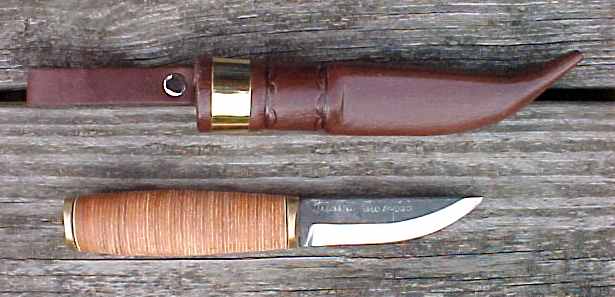

Well, Jarvenpaa makes a classic puukko blade with stacked leather:

I have a Jarvenpaa in birch bark.It's a nice knife.I want to make something a little larger with a stronger tang and a much more rounded and smooth pommel.For me the handle is a little short on the Jarvenpaa and the pommel is a little small with unnecessarily sharp edges.

I didn't mean for my reply to come across as a smart remark.I appreciate the refrence and picture as that is close to what I have in mind just with a few modifications.:thumbup:
