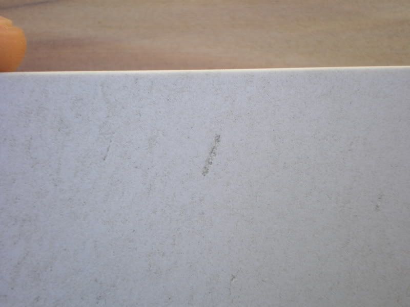

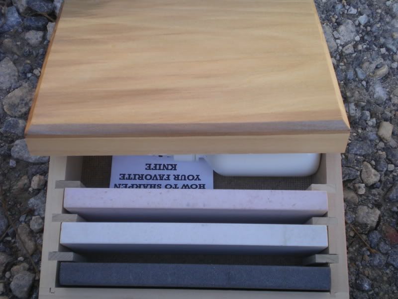

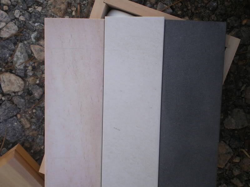

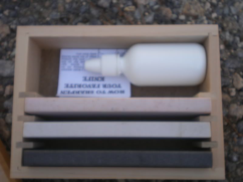

I got the stones today, well actually only the ones I ordered from Natural Whetstone. Overall I really like them, I would have liked the box to have been of highter quality, but it will do just fine (I plan on staining it and woodburning something on top). The stones look great, but the hard Arkansas has little dimples in it that I havn't seen before, almost like a worm groove? The Black looks great and it feels a little more aggressive than my translucent. The stones have a good bit of bite to them, which I like. Some natural stones tend to feel smooth when sharpening and I can't tell what is happening. I don't like to use oil, so I took out the bottle of oil that came with it and made my own water bottle out of a bottle of nasal spray, I dumped the salt water out and put freshwater in it, works great. I think it is a very good setup for the money. I tried using sandpaper for stock removal, and it works perfectly, it will help save my stones for sure. Thanks for the tip. I have gotten a feeling that Natural Whetstone is a VERY small company, the picture they show of their warehouse is a little metal building and the box they shipped the stones in was packed with newpaper instead of foam peanuts, I rather like dealing with small companies. Here are some pics.
BJE, those look like very decent quality stones, especially at such reasonable prices. FWIW I've used novaculite stones with very large imperfections and have never seen it affect sharpening performance.
If you're going to use water instead of oil, just watch a little more closely for metal starting to load up on the stone; as long as it's only light, it shouldn't be a problem to clean off.
I have been using these stones all day and I love them so far. They work very well and feel great while sharpening, they are the perfect size and they look so good, they have character and history. I especially like the black arkansas, once it gets wet, it turns solid deep black and it looks perfect. Is it a bad thing when you start to think that the stones you use look better than the knife you are sharpening? Once I get my India stone, I think I might just have a perfect set-up. I will start will silicon carbide or sandpaper for making a new edge or sharpening a very dull knife, then move to the India stone, and then the Arkansas in order coarse-fine, and then ceramic rod or strop depending on the edge I want. It has worked well so far, except for the India stone as I don't have one yet. I havn't tried it on any super steels yet, I think this is where it might take a while, I have heard that arkansas stones don't cut the super hard carbides well, but I am not worried because I edc carbon steel. I would really like to get a belgian stone, those look nice but the prices...not so much. This might become worse for my wallet than knives, bying the rocks that make them cut:)
