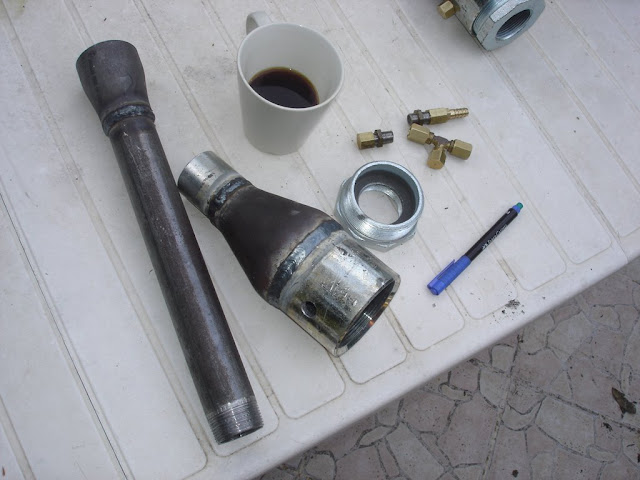

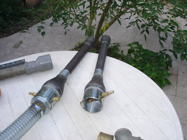

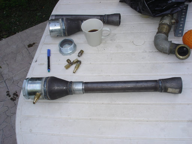

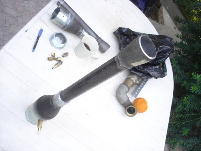

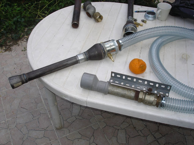

I finally finished my burners :D:thumbup:
I had some problems of finding the right size materials thus the burners have become huge :eek: . Total length is 20" :eek:.
the burner orifice is totally interchangeable and protrusible. Hence I can tweak the venturi performance.
Now I tested these burners with 1 and 2 mm orifice holes. As Stacy stated 1 mm hole is really good for venturi mode, but for forced air style the 2 mm hole orifice performs better. I have also 1.5, 2.5 and 3 mm orifices to test. But atmospheric performance should be tweaked a little more by extending the orifice length, moving it to the reduction base about 15 cm...
The burner consists of 1 1/4" burner body and 1 1/2 to 2" reducer welded together.
The top portion is 1 1/4" coupling + 1 1/2 to 3" reducer and a 3" coupling welded together. If wanted a 3" to 1 1/2" flat reducer can be mounted to connect air hose...
Here are the pics:
I'll tweak those a little but as it is they are great performers as far as I see. A choke is to be made for those, but I mainly work on forced air...
Emre
