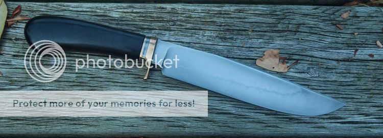

What do you think of this? *Video added*
Nick,
I am a fan of the design choices. The finishes work very well for a mid-range knife.
If I were looking for a mid-range "user" I would be looking for a smaller scale knife. I haven't stabbed anyone in quite a while ;), so a blade designed with more utlity and a little less style (length, pointiness) appeals to me. That said, I think smaller scale with the same lines would be appealling as a "collector" especially if it came with a mid-range price point.
Thanks for taking the time to comment guys. :)
Pat and Ken- I'm not sure I understand what you're seeing--- do you mean the way the dropped edge is shaped? It's actually an arc... but maybe I'm just not on the same page yet. :foot:
As far as the blade shape, it's very function driven--- the long/lean point has scarey penetration, there is a lot of belly for a slashing cut, and the slightly raised/sharp clip aids greatly in a back cut.
But I don't expect everyone to like it, so I'm not arguing here. :)
I added a video to hopefully show the knife a little better and maybe clear up some of the issues being mentioned. Maybe... ;) :)
Thanks! :)
Hi, Nick.
I can't speak for Patrice, but see the markup below. That is what I am talking about.
As for the blade shape . . . let me ask you this: as a user knife, what would you see as the primary uses for this knife?
Regardless of my thoughts, it is obviously a big winner here and I'm sure you'll do very well with it, as with all of your knives. Congrats!

Looking back at my photos, I can see where it looks like the dropped edge is sort of angled out away from the ricasso, but it really is a round-ish arc.
Ken- I really do appreciate you taking the time and thought to type out your response. Constructive criticism is welcome in my book. :)
Really, for the average guy, this would not be and EDC. I see the size, shape, and overall style as a good fit for a soldier, or as a last ditch defense tool for someone. With a soldier in mind, I think a synthetic handle would be a better choice. In fact, I initially planned to use G10 or Micarta. However, I thought putting a quality piece of wood on the knife would help make this knife "bridge the gap" between users and collectors.
Hopefully that makes sense. :foot:
Thanks guys :)

... As for use......if you guys need to be told that this is a blade designed to be a carry self defense blade than ya need to study up on blade design a bit more :)
A fighter for sure! I like the finish a lot and with a G10 or Micarta handle, this would be the perfect "woods-defense" knife in my world!
There's LOTS to like about this knife.
I'm not in love with the handle profile (from the side), though. I feel like it doesn't have quite enough... intention. The top view looks lovely. And I'd go with a pin one size larger, which I think will look more proportional when flat (vs. domed). That's about all I'm qualified to discuss. :D
The blade and guard are very nice. I applaud your mid-range attempt, and will follow the project with interest.
In the video I know you say the pin is centered in the handle height.
In this photo "the pin appears low to me" but the photos are on an angle
My eye is wanting to center the pin in the flat side as defined by the profile ridge line that comes down from the guard.
Maybe having it in different photo angles, or in hand it appears different.
If you still have it, how about straight on profile photo ?
It does look fast
What's it weigh?
I like this piece, and an especially good value at the price point. I do like a little bigger pin, speaking of the pin, it looks a little off-center, probably just the photo angle.
As for the bolded comment above, I think Nick could post a knife on this forum with a tin blade and a broom stick for the handle and get favorable responses. ;):D
But seriously, Nick has as large if not larger following then any maker on this forum IMO.
and deserves it at least as much as anyone. One of the hardest working dudes I know.

I totally agree with this thought path .. it's definitely a fighter style/design knife .. except, it's not a service revolver, this level of knife (IMO) should be compared to a tricked out Kimber .45 ACP or some other high end elegant and traditional personal weapon.
I like the transition it gives the longest edge...
Joe, in this case it is purely a visual thing. I would not have commented if it made a real difference in the performance of the knife. A completely round transition could be done with removing maybe 20 thou at most from the edge, if even that. I am no self defense expert but I am pretty sure that if you didn't do the job with the rest of the cutting edge, that last little bit won't make much of a difference. ;)
I think whats messing with ya guys is the pin to me looks centered on the handle just not on the flat which will cause your eyes to push to see it not centered if that makes sense. Ofcourse I could be wrong.
You are right my friend it would never make a difference
Just Nicks way of being a tad bit different
