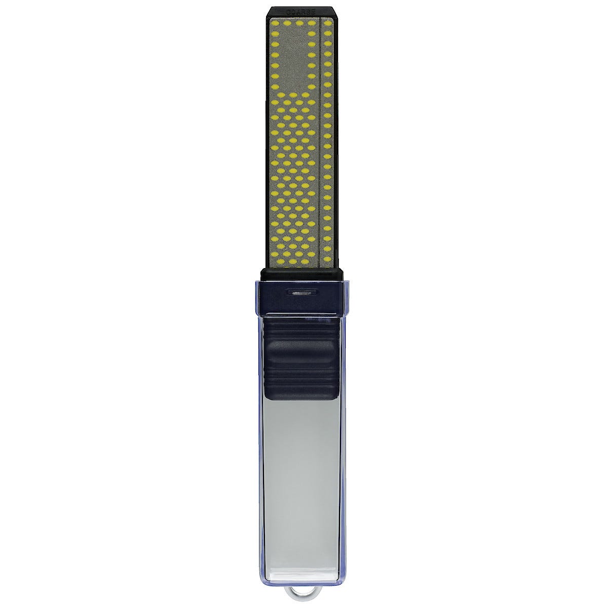

The DMT Diafold HC sharpener has 2 sides: fine 25 Micron 600 mesh and extra fine 9 Micron 1200 mesh. It is supposed to withstand the rigors of ceramic sharpening and also blades with hard Carbides like Vanadium Carbide.View attachment 1710822
