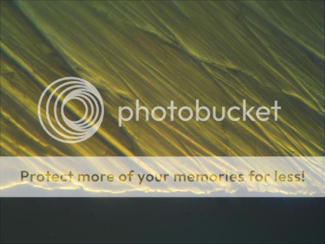

I have access to a metallurgical microscope at work - I have yet to find a burr at higher magnification that couldn't be seen at 15x. Tho the pics are pretty cool.
This is 1095 carbon steel off a King 1200 grit waterstone - at 1600x - pretty neat patterns in the grind from using a slurry.

HeavyHand, This is very interesting! So, as long as we're not finding it with a 8X, your not finding it with 1600X. Good to know. I use a 8.5X OptiVisor headset. These are not cheap but allows for hands free use. DM
Not yet, though things do look a whole lot different at that scale - huge difference from 120x to 640x. At first I couldn't really see much of a correlation between looks and performance. After looking at dozens of edges, now I can tell pretty well how somethings going to cut by how it looks at that magnification. My father in law spent many years designing and testing cutters for industry assures me that anything under 2000x is quite crude, though it is "a good starting point"!
