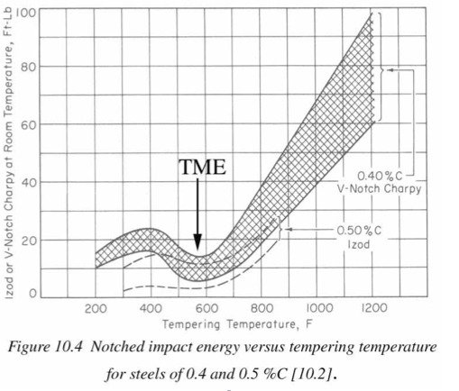

I just got news from the maker that he tempers O1 to around 57. Thoughts on this hardness for O1?
57 sounds like the blade is going to have Tempered Martensite Embrittlement (TME) because it was tempered above 450°F but below 700°F.
But maybe he has some way of preventing that, but 57 Hrc implies a temp around 500°F.

He says he tempers the blade more than once (I assume twice) to get it that low, so by doing that does he avoid TME?
Anyway, he said he'll only temper it once so that it will be harder for me. I prefer a Rockwell closer to 60, anyway.
