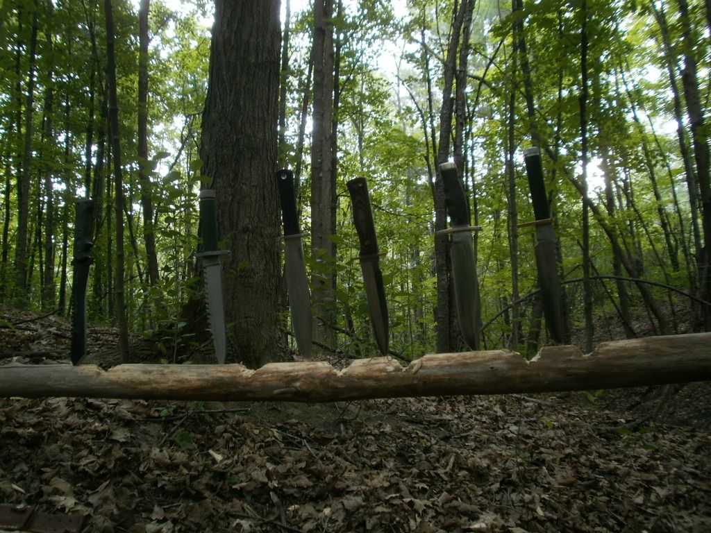

So I am not the most experienced guy here and 100% NOT trying to start an argument. With dedicated choppers, what you are saying makes sense. However, when you do stuff other than just chopping, like carving or battoning, you inevitably "twist or roll" the edge and put lateral / torquing force on the edge. In that case, doesn't it make more sense to have a slightly more obtuse edge?
My sample size on this is pretty small. However, I put a 15 dps edge on my Condor Kephart. It promptly rolled in a few places from just basic carving. However, at 20 dps it held up fine. My BK9 is used only as a chopper. It has a 10 dps mirrored edge with a tiny 20 dps micro bevel (done by Josh at Razor Edge), and it has held up great... I am not sure what all that proves, but I know I am nervous about going below 18 dps on a user.

BTW, i like your collection of big knives. Nice pics!
Thanks!
