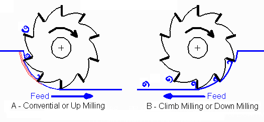

So I wasn't able to get a HSS 2 flute end mill locally so I will have to order one. I was able to buy a 1/8" carbide 2 flute end mill fairly cheap, they gave me a deal on it because they didn't have the HSS one they said they did when I called:thumbup: I gave it a quick test run and it cuts truer that I thought it would, the only deviation from my line was caused by my vise not being square to the carriage, something I can easily fix with a little of attention. To me it isn't that bad for a quick thumbs up alignment, .01" over 1". If I actually put the square to it I should be able to get it bang on perfect:cool: I will still do a few more test cuts tomorrow, just to make sure I have got it.
Now the first cut is a no brainer, it will be a plunge cut, but after that what direction should the end mill be traveling while cutting A or B?
I am thinking A because B looks like it would be more prone to deflecting out of where I want to cut.
With that bit of information, climb and conventional milling, and some reading it sounds like conventional milling is what I want. I am more concerned with accuracy and saving my end mill than a nice finished surface. I will be taking shallow cuts and feeding really slow for those reasons too.
So it looks like I got this guard slotting thing sorted out. I made a couple of test cuts yesterday and was still getting some drifting in the slot, the first cut would be fine, but when I started the second cut to widen the slot it would drift in on itself. That is when I noticed that the Y axis on the vise was homemade and loose enough to allow the vise to move while I was making a cut. My solution was to take the vise carriage apart and add a set screw so I could lock the carriage at a set height for each cut. My last test slot worked like a charm. Only problem I am having now it getting the cutting fluid into the cutter. The cut is well covered in the machinery, the end mill is only 1.5" long, while I am working on it and the bottle that came with the cutting fluid is too big to fit in safely. My answer to that is to get a spray bottle so I can squirt fluid in from a safe distance while cutting.
