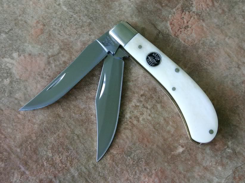

Schrade half sabre blade:
Case red bone:
