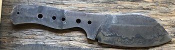

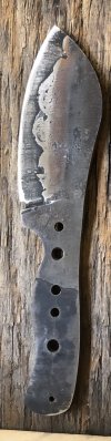

I’m new to making knives and not sure what happened with this hamon. I had the clay 0.5”-0.75” from the edge but the hamon line is right at the edge. The pictures show what it looked like after the first few cleaning passes post quench and temper. You can see a faint line where I thought the hamon should be. Any thoughts? I’m not going to lie I don’t remember if it’s 1075 or 1084. I just grabbed a piece and started grinding.B8009B27-6714-4878-AFC7-851684F6841F.jpegB040E660-9BC6-499E-A312-1BBE4BEBD3BD.jpeg4377072E-E8E8-444A-A277-D46C8601A19F.jpegC4AAB392-0631-42CF-B46E-89CF7A7A2CEF.jpeg
Clay was either too thick or too close to the edge, or you didn’t let it soak long enough at your hardening temp. Couple different variables that can cause the hamon to be lower than your actual clay line.
Several possibilities:
Too high a hardening temperature (most likely cause)
Clay too thick (probable cause)
Clay too close to edge (probably not the cause)
Too much manganese in the steel (always get an analysis report when buying steel)
Thanks for the feedback. I have an actual oven I’m using that holds temp. I put the blank in when I started the oven and I left it in there for 15-20 minutes after it reached temp then quenched in Parks 50 I had heated to the 130-140 degree range. I’m thinking I may have had the oven too hot. I got my oven from my dad and he said it runs a little cool so I set it at 1590 hoping it would be in the low to mid 1500’s. I’m trying to figure out a way to get an alternate temp indication so I can confirm where it actually is. I didn’t think they clay was too thick (maybe 1/4”) but I’m just judging from pictures I’ve seen online. I did work to even it out and get it a consistent thickness everywhere.

Generally, you want to put your blade in once the oven has stabilized at temp for 10-20 mins, then start the timer after it gets back up to temp.
That way, the oven doesn't overheat your blade on the way up to temp.
Parks 50 should not be heated unless it is below 50 degrees. It should be used at room temperature. The max working temperature for it is 120 degrees.

Just etched this one this evening and am pretty pleased with it. I probably had the clay too thick on it as well but at least the line isn’t at the edge. It’s 1075. Haven’t quite figured out how I want the handle to look yet.0D99C29F-C587-4B7D-BB76-A1EAF5F79675.jpegEF1C3C0E-5C6D-4FE6-8602-C59CF256C2C4.jpeg
Too hot and wrong quench temp.
The parks at 130-140° was the biggest issue - Use it at 50-90°
Low 1500's° was too hot - 1080 quenches at 1475°, and even a little lower when seeking an active hamon.
Go ahead and re-do the quench with thinner cay, unheated #50, and 1465° as the oven temp.
