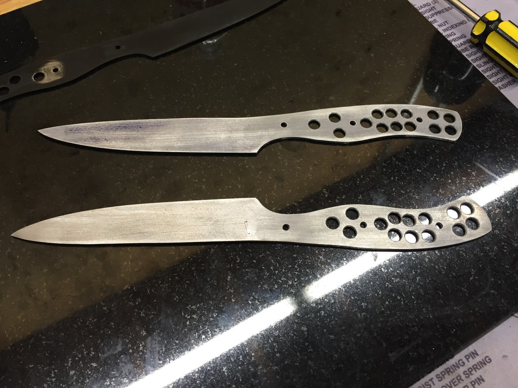

Question for all of you with experience with AEB-L. What hardness do you/would you typically want for a kitchen utility knife? I'm about to send these off to Peter's Heat Treating and I was thinking 60-61, thoughts?
Thanks in advance,
