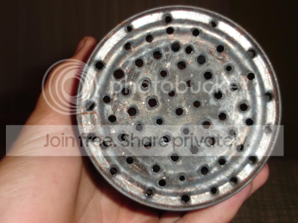

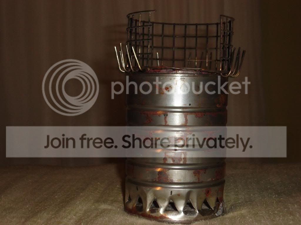

well im poed because i have 2 ear infections and i feel like crap. Well it gave me some time to play with my tools. This is something i have been wanting to do is to make a wood gas stove for hiking/backpacking. well i saw the bushbuddy and got a general idea of what i had to do. and here is just like a proto type made out of cans. It works realy good for what it is it boils 1 liter in 8-9 minutes. i think it will work good for hiking so i can make coffe and food and such when im out on the trail.

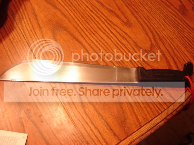

also i took the coating off my ontario 12 inch machete that was given to me by rescue riley Thanks rescue riley.
I have used it to make small fire wood out of tree trimings also i have used it to clear brush and limb cedar trees to make ceday posts and this machete bites realy deep because it only 1/8 but it works realy good on green wood im going hiking when i get better and see if there any fallen trees i can chop up for fun and ill take some pics of chopin and my stove.
NICELY DONE wood gas stove!
are you being sarcastic? to me the was just to see how it works and seing if it was worth to go deeper into making a better one and it is me and my father are going to make it he has been a sheet metal worker for oven 30 years so it should come out good.
