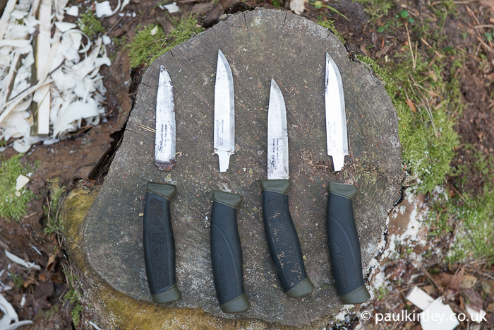

I watched a lot of Joe X videos. The companion and basic 511 were snapped easily, either by prying or whacking on a steel pole. I think because they are 2mm thick, they could not withstand these tests. However, I don't think this is representative of tasks you would actually do. The one that did not break was the Craftline Robust.
The type of failure, which is possible during batoning (I feel this is a legitimate task), is the blade snapping, as in this image:
There are multiple cases of this happening. I get it, these are cheap Companions and 511s that fail this way. The Robust, Companion HD, Garberg, Bushcraft, would not have such failures because they are designed for this type of use.
