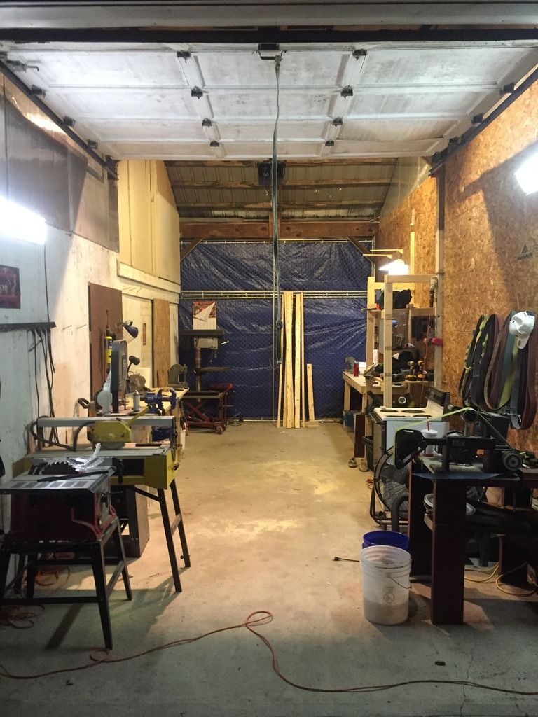

Moved into the new shop and have been getting it set up. Still have to drop in the 220V electric and put in a shop sink. No running water, no heat, but its cheap and will hold me over until I'm done with law school and can get a real shop.
Built a couple work benches and slapped together a poorly engineered storage shelf.
Moving everything was tough but I had help

Workshop is looking good too. Better put some heating in there before winter comes!!

I have seen a lot of shops, and there's absolutely nothing wrong with yours. You can get a lot of impressive things done in a far lesser shop than the one you have now.
With no water, how are you going to supply a sink? Are you recirculating the water? Solvent tanks do that, so you could probably do it with shop water too. The amount of water you would use might be small enough you can just pour it outside and let it evaporate.

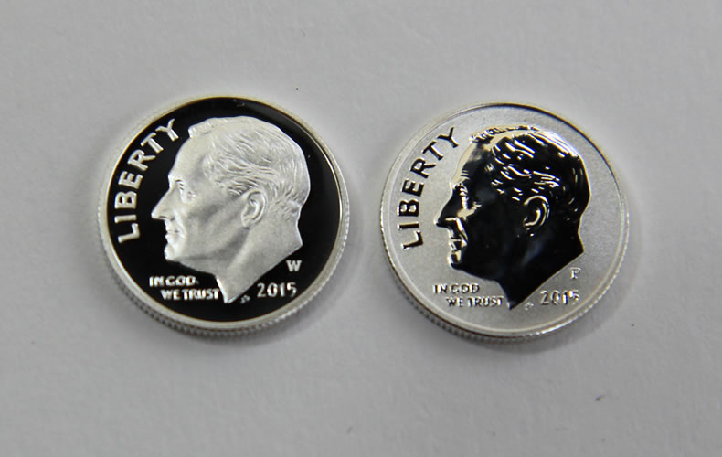

I'm imagining a luxurious safe-queen blade with ice cold frosty surfaces and a brilliant mirror-polished edge. It wouldn't stay looking that good if it weren't a safe queen, but considering how cheap it is to make a blade look so uniquely beautiful, the investment might pay for itself pretty easily if you wanted to make something special for the blade connoisseurs, to improve your profit margins. It wouldn't need to be so much more expensive that people would be afraid to use it, but connoisseurs might be tempted to buy both a user blade to get dirty and scraped up, and the same blade with the gorgeous frosted finish on it. One is a working tool that gets used and abused, and the other gets admired for its beauty.
There are a lot of sandblasted and satin finish knives in the world, but to my knowledge, no one has ever utilized the impressive cameo contrast you can get when you combine a mirror finish with a frosty finish. Coin die makers have been doing it for centuries, and the effect is pretty impressive:
Coin die makers can use either actual sandblasting, or a chemical pickling process in acid to get the sandblasted effect. You could selectively use mirror and frosty finishes to create your logo and perhaps custom text across a blade. Now that I'm thinking of it, a tribal tattoo or barbed-wire design across a blade would be ridiculously beautiful. For sandblasting, you would use a rubber-like compound that can resist the sand impact without being worn away, for the mirror areas. For pickling, you would use some kind of adhering barrier to keep the acid from attacking the mirrored parts. Both methods require the whole blade to be polished. You could use orbital sanders, buffing wheels, and other power tools to speed up the polishing process.
For coin die makers, they only need to do the work on the dies, and then they can use the dies to mint thousands of coins before they need new dies. That keeps costs low. For the blades, you would probably need to manually apply the finishes to each blade. Frosting is cheap, mirroring is expensive. If you only wanted to mirror a logo, maybe you could mirror a small patch on the blade, layout the areas that distinguish the mirror parts from the frosted parts, then go ahead and frost the entire thing all at once. That could minimize the area that needs to be polish, to speed up the process for each blade.

The sink will be supplied from a 7 gallon tank and will be pumped through the sink. The sink will drain into another 7 gallon grey water tank that I can just take home and dump down the drain. Running water would be really nice but I think the setup I'm building will do just fine for cleaning blades and washing my hands.
