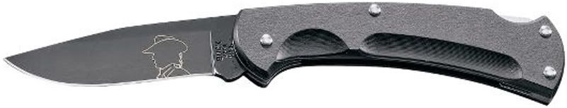

My brother [I think] bought a 2010 paperstone 112 that was odd..The BOS designation on the back of the blade was 12C27M ..Hmmm...Listing described it as 154CM. Does Buck use this?? And maybe call it something else?:confused: He said he "might" give it to me for Christmas The BOS logo was on the back of a coated 450 blade Black handle with NO Buck logo......Sample steel maybe?? Thanks all!
Sitflyer,on a old thread you brought up a knife similar to what Dave has..This has a outline of a guy wearing a hat..
Yeah, Buck uses 12C27M on some knives in the catalog also. The knife you're asking about is below. The listing description must have been a misprint or a mistake.
"Buck Knives® Jim Shockey Signature Series Ibex Knife
We've teamed up with Buck Knives and Jim Shockey to create an exclusive line of knives. Using the finest components, like Sandvik 12C27M stainless steel blades, ensures these knives are worthy of the Jim Shockey logo. Jim is well known for his saying that he trusts his life to his gear and that you can too. And the same holds true for this line of high-quality knives. Ibex comes with a diamond-coated sharpener. Made in USA.
Available:
Ibex – This lightweight lockback has a 3" clip blade and black PaperStone handle. Nylon-molded sheath.
Overall length: 7-1/2".
Weight: 10 oz."

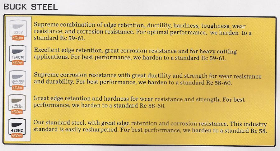

Thanks! I wonder if it was a large run?? I confess in all the Bucks I have used and sharpened only a D2 118 could I tell any difference...[harder to sharpen] All the others seemed the same..
12C27M AKA 12C12MOD
_C_____Cr___Si___Mn
0.52___14.5__0.4__0.6
For comparison purposes, 420HC (Latrobe version)
_C_____Cr___Si___Mn___V
0.46___13___0.4__0.4__0.3
The 12C27M should be more rust resistant because of the higher chromium content. Based on the quote from the Buck website, sounds like they are hardened to about the same hardness. I would not expect the 12C27M to have noticeably better edge retention than the standard 420HC.
