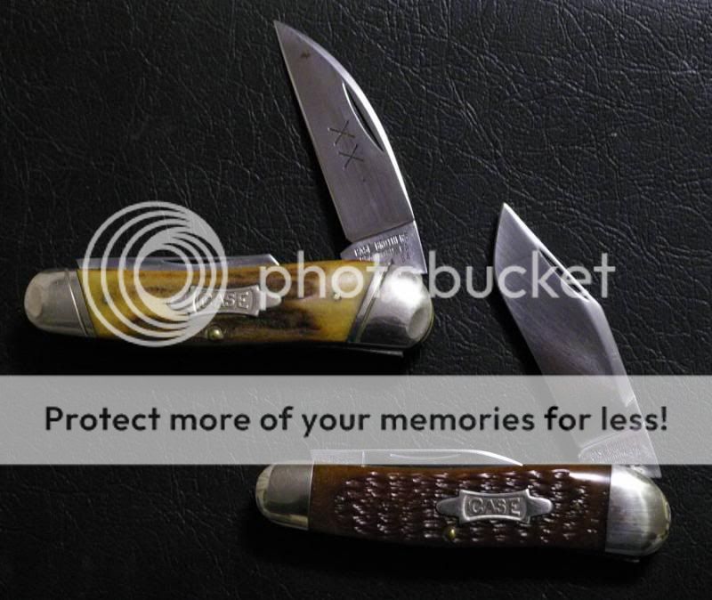

If you ask a Case collector, he'll tell you it's the 6380 pattern, like this one (not mine, pic lifted from the web).
Here's some examples of the Case 80 pattern in red and brown bone. It's my favorite pattern because of it's smooth lines yet hefty size!

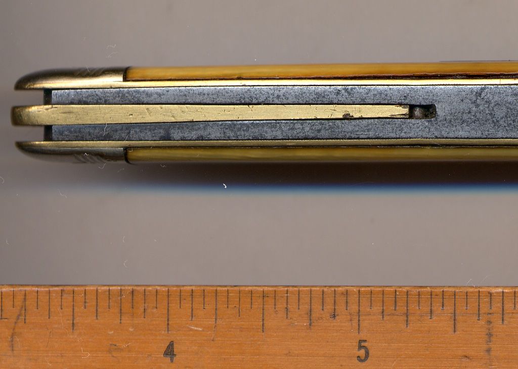

A whittler is a three-blade pen knife with a large blade in one end and two small cutting blades of equal length in the other end. Whittlers have two springs. Each small blade bears on one of the springs. The large blade is extra thick and it bears on both springs. The thick master blade bearing on two springs is the most distinctive feature of a whittler.
A side note about whittlers:
Two-spring whittlers are sometimes inaccurately referred to as split-spring whittlers... they aren't really.
Here's a photo of a true split-spring:

Second is a case posted by arathol in another thread. Very unique master clip. Love the almost tanto/chisel like tip.

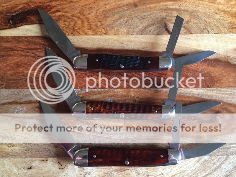

Just to confuse things even further, here are two traditional cattle knife patterns from Robeson, but with "CARPENTER'S CHOICE" etched on the master blade and a serpentine patterned stockman with "CARPENTER'S KNIFE" engraved and gold filled on the front handle.
And here is a knife Robeson made in both two and three blade patterns, a serpentine stockman type knife, but with a specialized chisel type blade. The master is etched, "WOODCRAFT"
Here is a hefty Robeson true whittler with blades useful for wood work.

These are beefed up seahorses or even a geppetto.
These two have a pull of about a 9. Which is good on this knife IMO because I am using them at work.
They are also 1095 steel. I like Queen's 1095 you can get a really nice edge.
