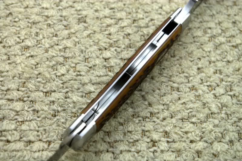

A catch bit can be used on one end or in some cases both ends. The main benefit of a catch bit is it allows the opposing blade to be full length. Without a catch bit the opposing blade can only be as long as the plunge cut. The pictures that are shown here is of a modified canoe with single spring.In this case there is a catch bit on both ends of this knife. The catch bit thickness is the difference between the tang thickness and the spring thickness plus .0005 (at least thats what I shoot for).

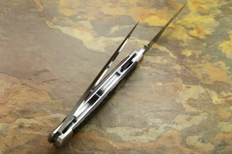

This is a double end serpentine jack with a catch bit only on the one end. This allows the master blade to be full length while the secondary blade is much shorter. This knife has a single backspring.

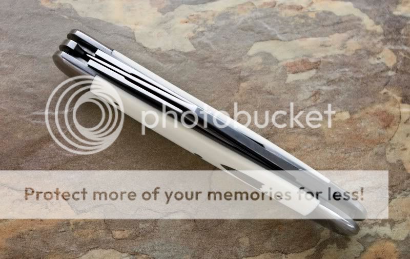

Note that the center wedge between the secondary blades of a whittler is also a catch bit -- if it's made thick enough, it allows the main blade to be somewhat longer since it can now pass between the secondary blades and be full length.
This is a muskrat with a catch bit on both ends
Whittler with center tapered spacer acting as a catch bit allowing master to be full length

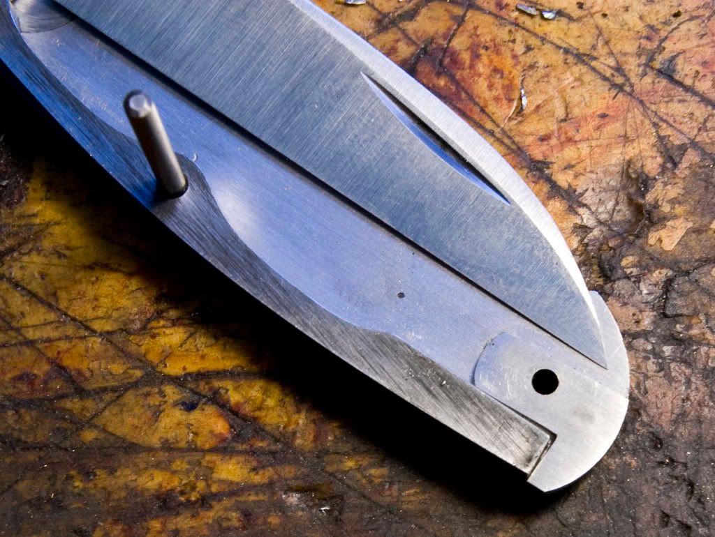

I relieve the catch bit also, otherwise it will scratch the tang just as an un-relieved frame will. I just do not relieve it using the mill. I use my belt sander and gently taper it way. If you look close at the double end jack you can see some space between the tang and catch bit. (sorry the pic is a bit out of focus)
