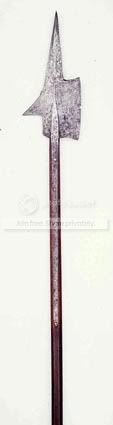

I see that Cold Steel has a langette as a option for the Rifleman's hawk. What is it?
Also, which length of handle do you recomment?? They have 3 lengths...:confused:
Langettes are long strips of metal fixed to the sides of polearms below the head -- axe or hammer or mace -- to strengthen the pole close to the point of impact.
I bet they were, in the days when polearms were life and death. Never beat on one myself to find out.
They would also reduce the chance of having the head of the weapon chopped off.
They were used for reinforcing of the shaft below the head. They also probably aided in spreading out some of the forces during impact.
