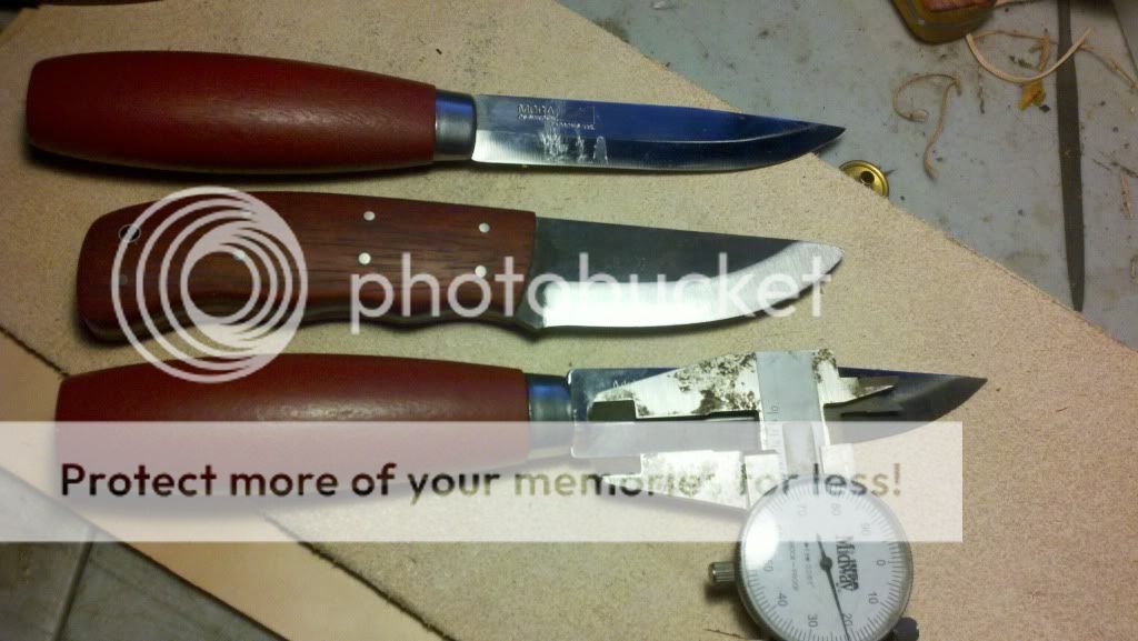

I studied the Mora from Sweden. Here is what I discovered.

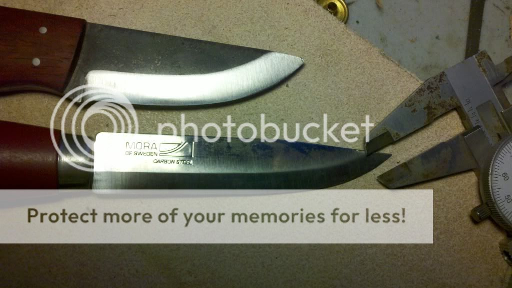

Here is a measurement from the top of the grind to the edge.
Here is the same .320 at the tip. It is obvious the angle of the grind changes from the rear of the blade to the tip.
How does this work when it comes to sharpening? Because mora's are HOLLOWGROUND. Not flat ground.

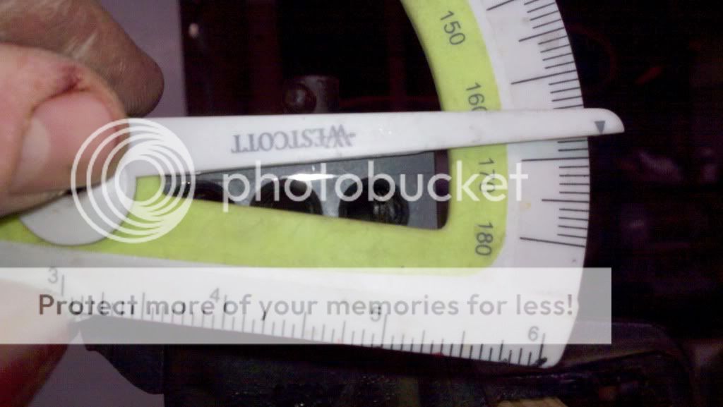

Here is a photo of a 123 block clamped to the blade. I used a height scribe to make a straight line across the front of the block.
Woops... look at that not even 12 degrees. More like 10......
I have known this since 2007. Just the first time I bothered to post about it.
I have used the 12.5 degree guide. I have 3 sitting in my shop. They make a knife that cuts good.
My knives cut BETTER when I grind them around 10 degrees, leave the edge around 1/32 of an inch, then convex the lower part of the grind to the edge.

Sweet and interesting, I can't really make out the measurement that you did, what is it? Do you think the distance from the edge to the top of the grind matters?

My best friend's dad always said that an 11 degree grind with a convex secondary makes the perfect knife :P. Interesting analysis--I was honestly expecting a micro-bevel vs. zero-ground debate. I suspect that the grind angle change near the tip is to increase tip strength for drilling, but I could be wrong

The distance at the back is .320 of a inch. That distance determines the angle of the grind. Thee angle dictates how the knife will cut.
