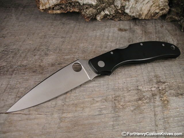

My favorite is the black polished micarta on some of the the early 90's Spydercos that I own, like the Calypso. I also own knives with canvas/linen micarata scales but they aren't nearly as attractive or elegant.
