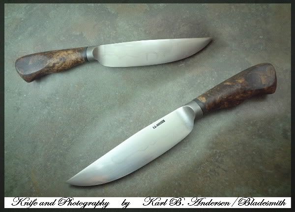

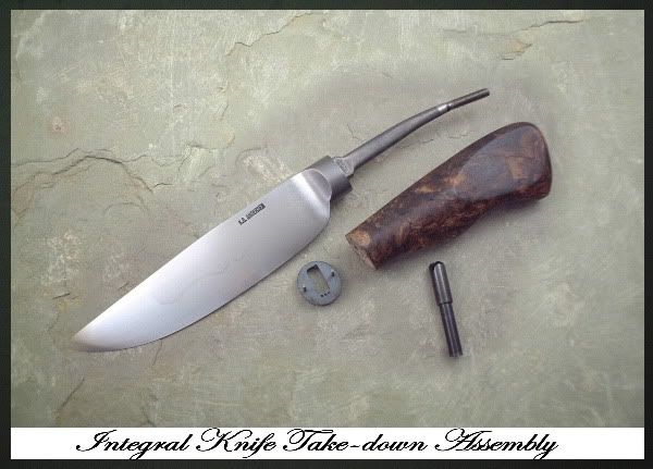

Karl: The integral you show has a different finish on the ferrule/collar ... is that integral to the forged blade or added after the forge? .... if it is added it is not integral by a lot of peoples definitions!
Cheers,
Stephen
I don't have a picture like this of that knife, but it is assembled just like this one. If we agree that an "integral" knife is one whose blade, bolster and tang are forged from ONE piece of steel, then it most certainly qualifies! That spacer is more a part of the handle assembly than anything else. It is used to anchor the alignment pins from the handle to eliminate lateral movement.
The blade, bolster and tang are forged from ONE PIECE of 7/8" round W1.
Being "take-down" does not disqualify it as "Integral".
