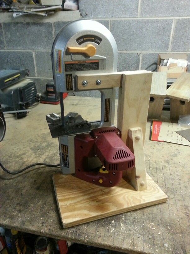

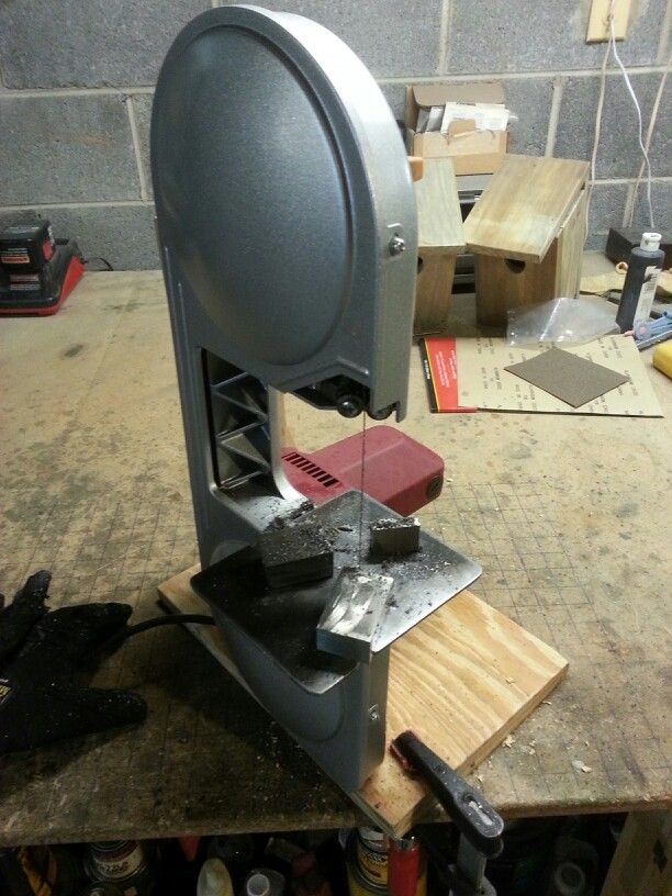

+1 on the porta-band. I used a Dewalt 238 clamped in a Craftsman work table till it blew smoke. Then picked up one of the HF porta-bands to replace it. Having it mounted firmly, adding a decent work surface and good blades will get you through anything you ever needed to cut. I used to be a 4.5" grinder/cut-off wheel guy because I swore it was faster... Yeah, but it wastes too much material and has safety issues. This is one of the best sub-$100 purchases I have ever made... As you can see, I am using it to cut some 1.5" thick 304 stainless guard material here with ease... Good blades make all the difference in the world, but to get started the three-packs at HF ain't half bad...
I mounted mine by the forward handle bolts, and keep the handle handy as I cut a lot of pipe as well so I take it off the stand often. Bottom is tight against the base and the front cover serves to index the bottom so to speak...

Bingo! This is what I use. My mount is a lot more low tech. I took the top handle off and put a piece of angle iron in between it and the body of the saw, put the screws back in through it, and mounted it to my bench. Works great. I've done probably 15 blades with it so far and am still using the first blade. It still cuts great but I oil the cuts.
