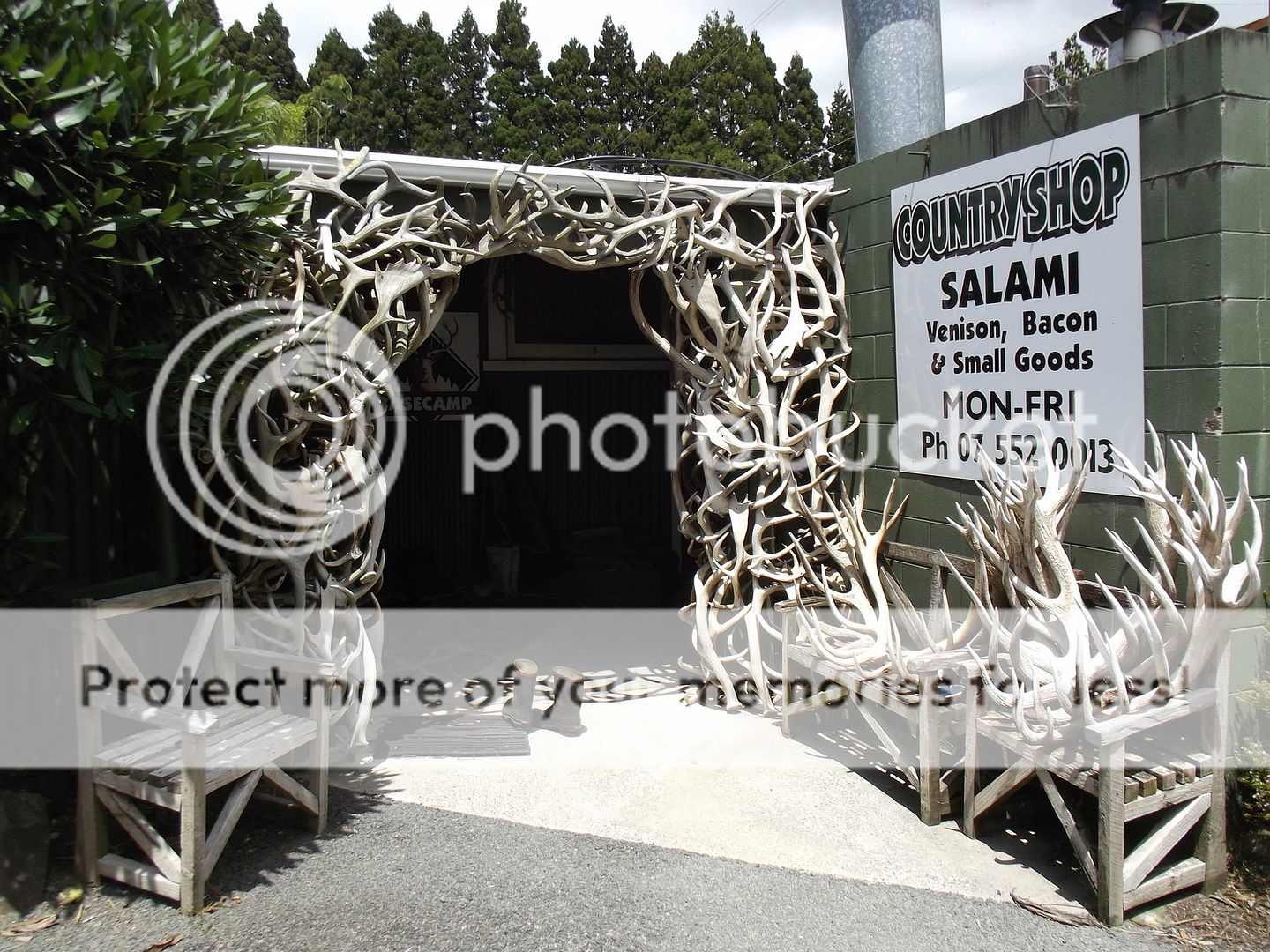

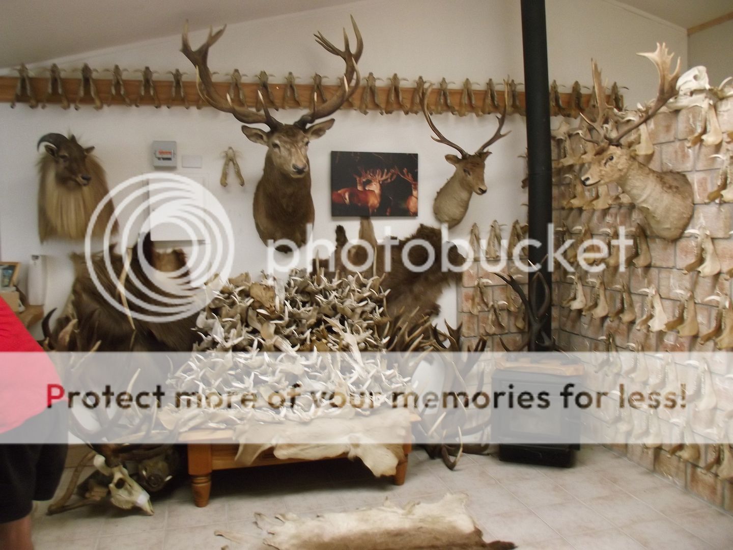

STAG....absolutely love the stuff and the animals themselves....A fellow New Zealander is undoubtedly the world authority on deer (Dr Bruce Banwell)...... FES

Her I am struggling to find a few nice tips for a project and you have it stacked around a door way.
I would love to get my hands on a few of those racks.

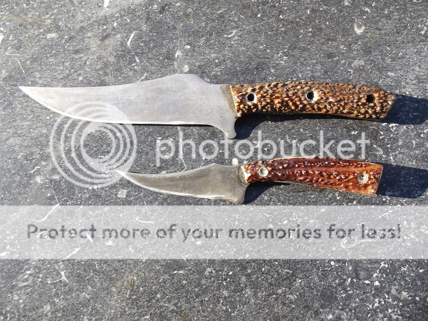

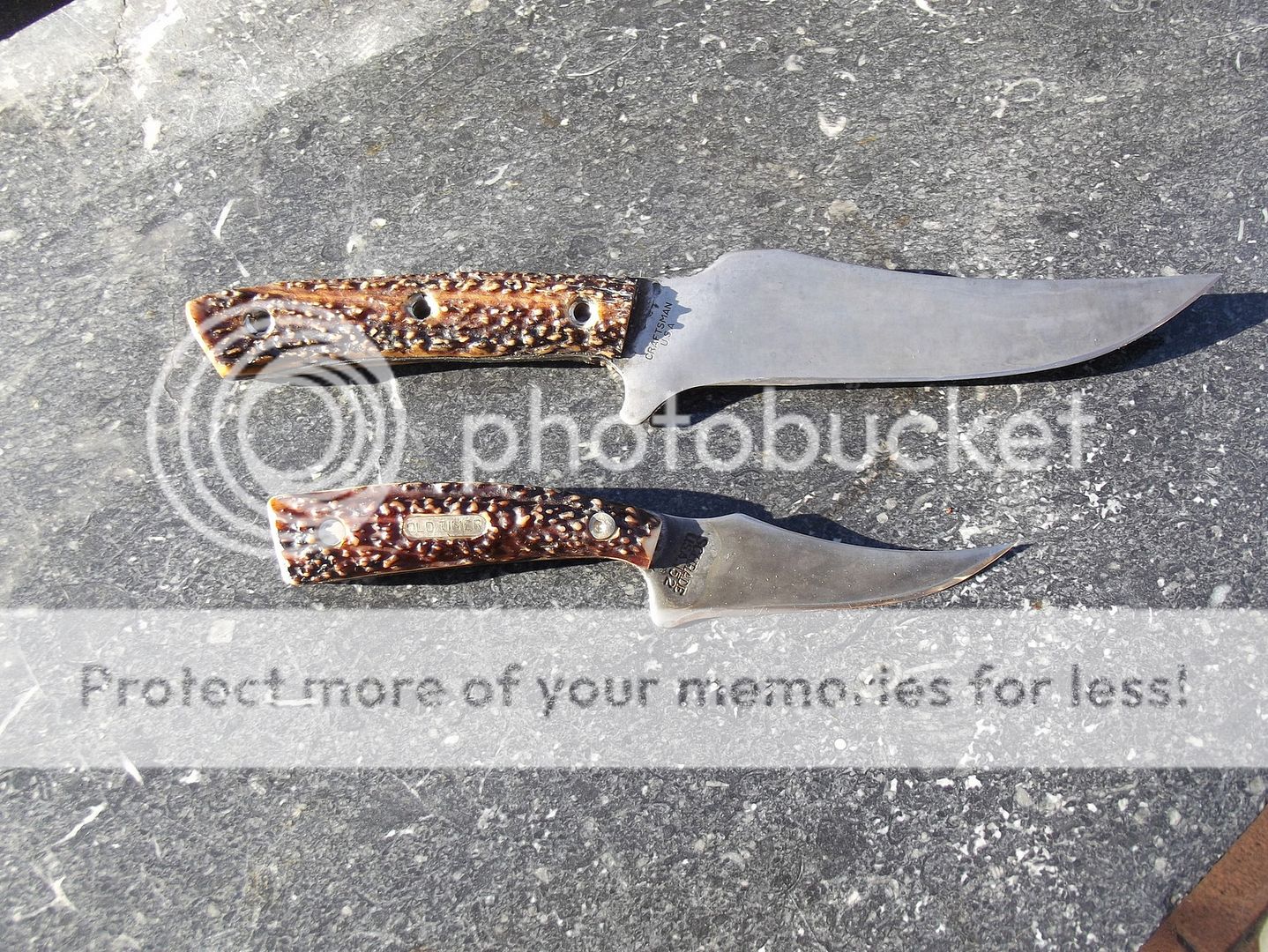

TURK...they feel great in hand,albeit a bit heavier than most synthetic grips....Heres my OLD TIMER duo i did in SIKA ........ FES
