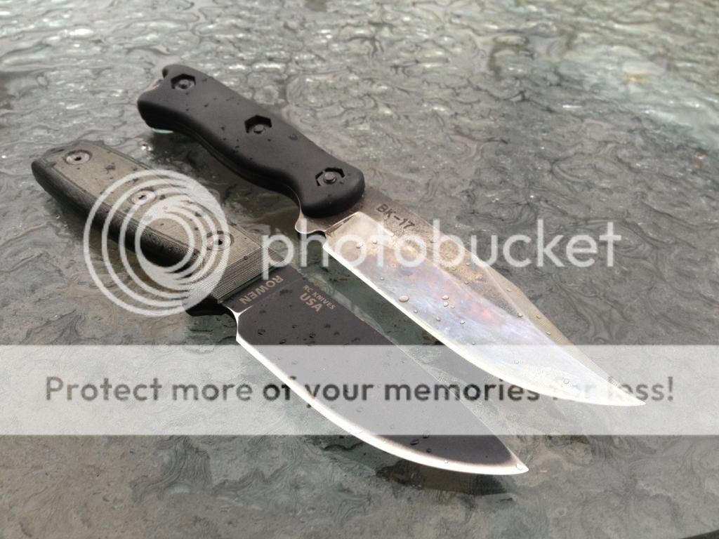

These are the ones that I use and really enjoy.
The clip point model is a Becker/Kabar Bk-17 in 1095. Not the hardest steel, but super easy to put it over a stone and get it ready to go in a couple passes. Harder steels will chip where softer steels will roll and can be re-aligned quickly.
Here is a video of the Bk-17 in action by Virtuovice in Japan, an avid stag hunter.
http://www.youtube.com/watch?v=smiqAqGzVkI&feature=player_embedded
The Drop point is an ESEE-3 (Formerly known as RC-3, there was a company name-change.) It uses the same 1095, which I find to be a great all-around steel, a bit old-school, but it suits me in the uses of game-dressing.
Both products are U.S. made if that is important to you as well.

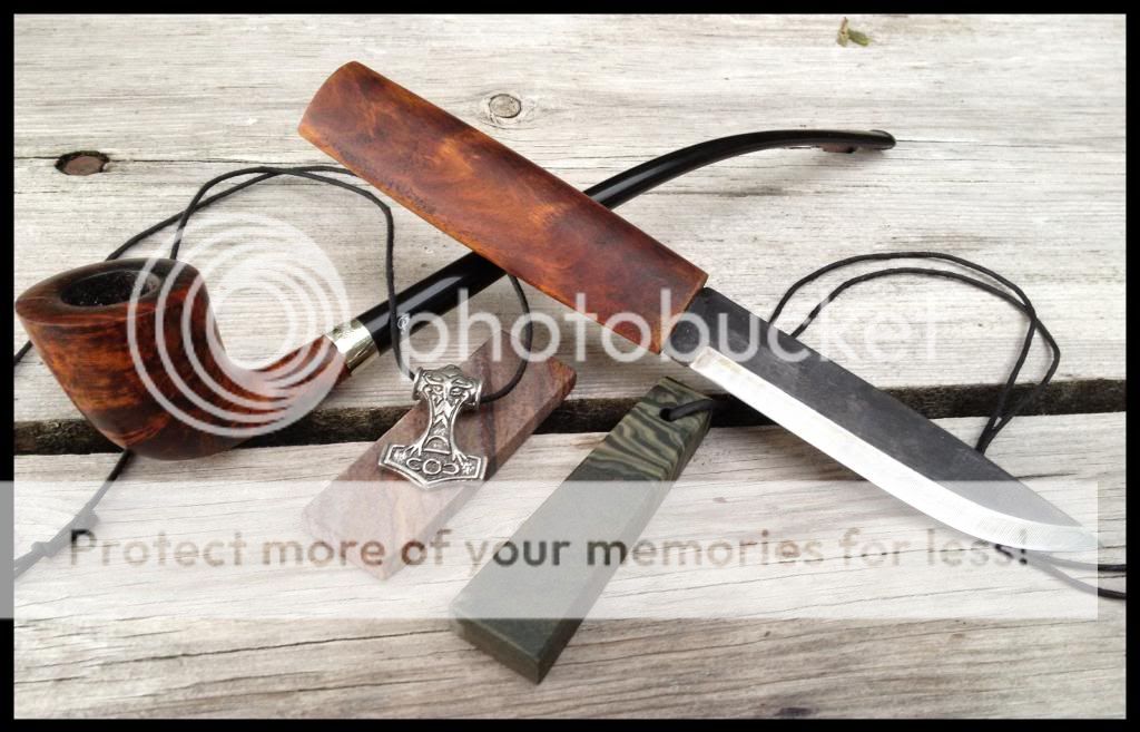

I have not tried this one yet on larger game, but I am eager to see how a Helle Viking does for the job, I did try it on a muskrat when it was the only knife I had with me while trapping, which it was a bit on the large side for, but still able to be used.
The thickness of the blade with a Scandinavian grind that has a slight convex to it from resharpening may either hinder or help with processing. Either way, I have enjoyed this knife for other tasks such as wood carving. It is a thick piece of laminated carbon steel from Helle in Norway, based on a knife found in a Viking burial I believe. The things that I like about this pattern of knife is how thin the blade width is, yet still has a nice belly towards the end of the blade for skinning, as well as a thick "rat-tail" tang that is peened at the end of the handle, making it not so cold on your hands during the winter.
