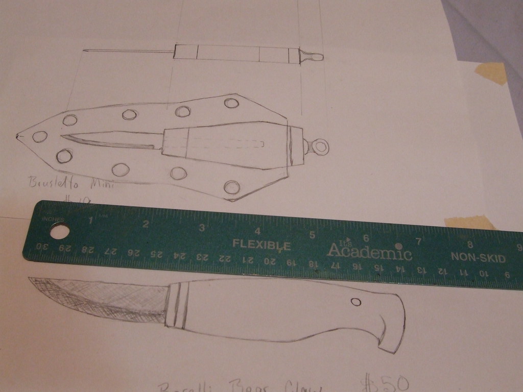

The picture below shows a couple of my recent ideas. I started out by freehand drawing some blades, mimicking Scandinavian profiles by Brusletto and Roselli. Then I got creative with the handle designs.
I have been doing ultralight wilderness backpacking, so I tend to think in minimalist terms. At the same time, I like fixed blade knifes, for their reliability, and I want to design a handle with a comfortable grip.
I don't like that sheath design very much. Looks too much like a space shuttle.
I like your ideas too: hunter/skinner and bushcraft.

You didn't ask, but I see this.
In the top down view of the top knife - the view above the space shuttle
I see a handle that has nice swell and curve in one direction, but completely flat slabs in the other view.
Think 3D and avoid the perfectly flat sides.
I am stoopid when it comes to CTS-XHP, but then again, I am stoooooopid when it comes to a lot of stuff.
In a nutshell, if you like CPM-154, you'll love CTS-XHP. And I don't think you're stooopid, just modest :D
I like the knife design.
It looks like a scandi, why not make a scandi style sheeth to go with it?

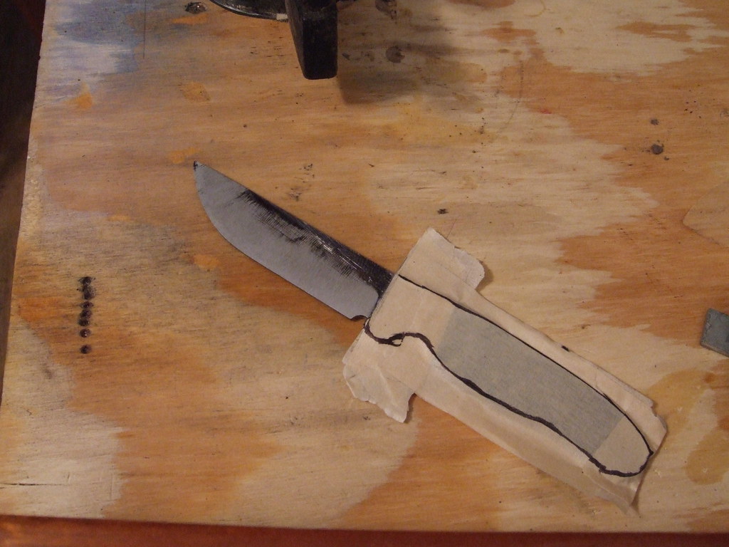

Here is what I came up with. See the picture below. It is my first attempt at profiling and bevelling since about 1991. I started out making a bushcrafter, and somehow it turned into this. It looks like a cross between a combat knife and a hunting knife? I don't see any combat or hunting in my future, so I guess I will use it in the kitchen.
I am not going to give it a high polish. From what I am reading here, 440C does not take a high polish. Anyway I got the bar off of ebay, so I don't know if it is good quality.
O.A.L. is 8 1/8" and blade length is 4 1/16".
