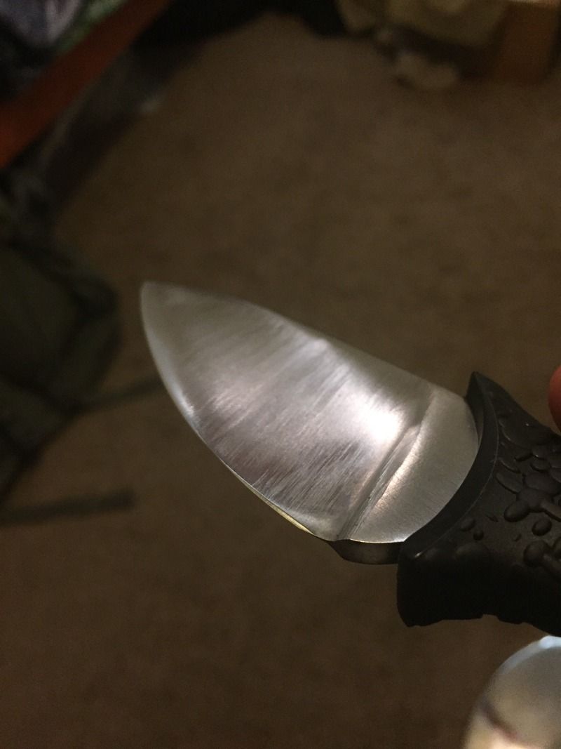

I reground this CRKT Ken Onion Skinner:
Tried to leave a satin finish, but as you said, the grind lines from my 36 grit belt were deeper than I thought. Can't get rid of them because any more metal removal will leave me without an edge.
I did not encounter much "grabbing" when doing this.
