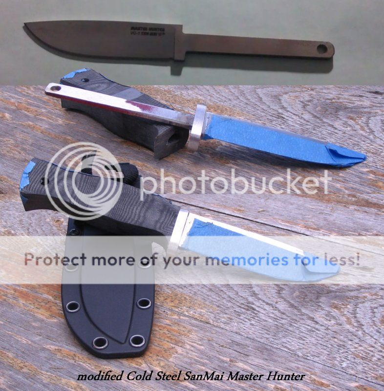

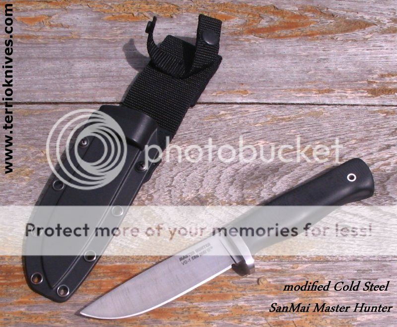

Here's a MH I rebuilt for a client a few weeks ago. I made this one with a solid block of G10 rather than mortised scales, but the general idea is the same.
That client wanted his as close to the original size and shape as possible. You could shape the front of a guardless handle like Samek's to snap into the sheath if you wanted. Or if you're going to make a new sheath, make it however the heck you want :)

Nice work. If you're careful you could still put a pin or tube through it. :)
