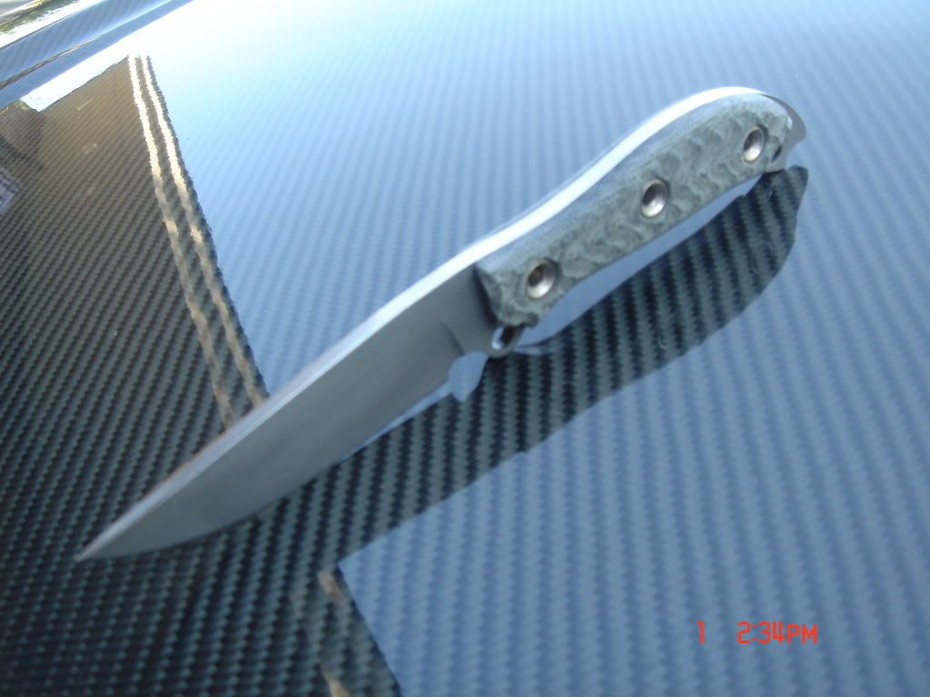

Here is a Hell Razor that I stripped using a chemical stripper. I submerged the HR in a chemical stripper and it did not affect the linen grips, no discoloration, no darkening.
My Hell Razor after stripping

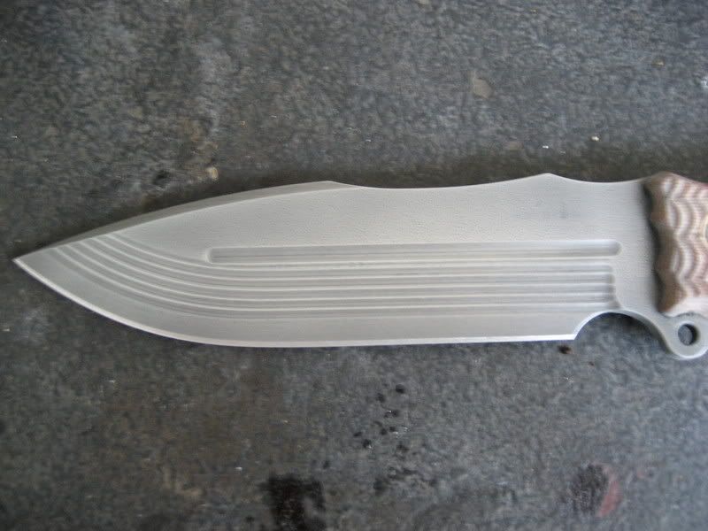

Getting the coating off takes only a couple minutes, no matter what stipper you use. It's not smooth under the coating though; there's dimples. It doesn't look like an LE satin. Making surface smooth and dimple free is a whole other beast. There are many techniques for that, which have dramatic ranges in time.
I've stripped an Active Duty and got a satin finish out of it in under an hour using an Scotch Brite attachment on a drill.

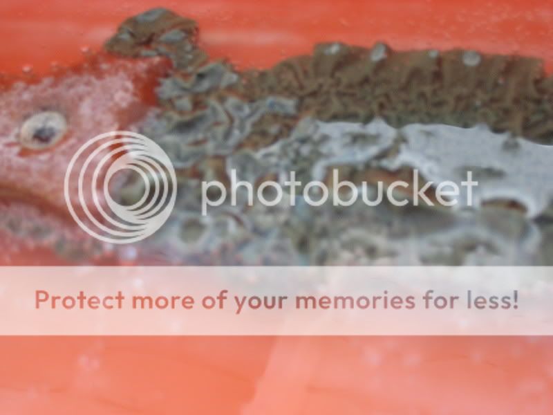

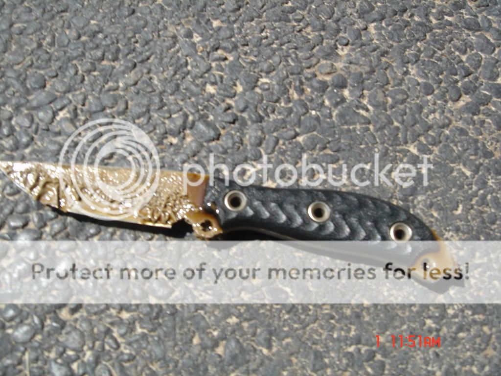

I used Klean-Strip KS-3 Premium Stripper from Walmart to do my Game Warden. It was a Muddy Crinkle finish w/ tan Micarta. I applied the stripper with a small paint brush and immediately the finish started to bubble up and fall off. The first application got most of the finish off, then it was just a matter of spot applications. I got this stuff all over the micarta and it did not affect it at all. Sorry for the poor picture quality, but I am using a camera phone until my Canon Powershot G9 gets here (thanks Lunde for the advice on the G9).
The first 2 pics are right after stripping, the rest are after using the Scotch Brite disc in a drill (thanks Damn the Man)

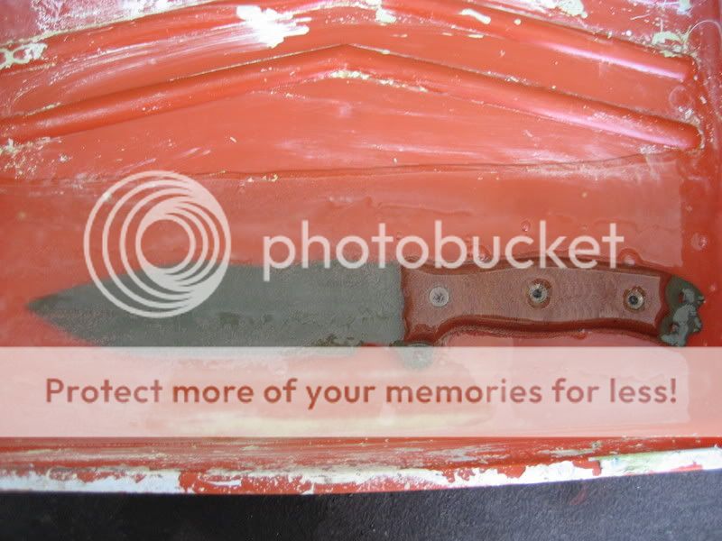

I just submerged my meaner in paint stripper canvas and all.
Turned out pretty well. I never even had to touch up anything.. washed it off with water, dry it, good to go..
I was initially very reluctant to get the stipper chemicals on micarta or Res-C. Over time, I realized that the chemicals do NOT hurt either. I have now had plenty of stripper on plenty of micarta and Res-C without seeing ANY damage to micarta or Res-C from chemical stripper.
* I suppose I should qualify the above statement by saying: The Jasco brand gel type stripper I have personally used has not in any noticable way damaged my micarta or Res-C after up to 10 - 30 minutes of contact time. (** Don't breath the fumes from the stripper!!! - Use chemicals outside with good ventilation!) Actual time needed for chemical stripper to remove coating is about 5 - 10 minutes. Then I scrape, wash with dish soap and dry completely. Unfortunately, stripping pretty much has to be followed with a lot more work to make the blades look decent. The raw blades are generally decent as far as relatively smooth on the primary grind areas - although there is usually a dull gray that needs buffing off. But, the flat sides of the blades are VERY rough and usually fairly ugly.

Some blades have just a lot of dimples. But, sometimes there are all kinds of zig-zag machine marks that can be very tough to get smoothed out.
Sanding belts are a different story. They will cut up Res-C. If using a belt sander to remove all of the many pits and marks under the coating, be careful not to let the belt touch the Res-C. The belts will cut into the Res-C. Ultimately, this means it is very hard to get rid of or otherwise finish the pits and unfinished areas around the handles at the ricasso and pommels of coated knives.... :(
