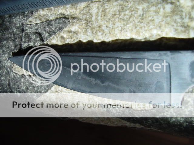

here's one I just finished up today....1095 with just plain ol' satanite, water quenched:
I don't mix mine with anything but water

:cool: S.:cool:That is going to be one fine hamon when you get it pollished out. I, for one would like to see it finished. Fred
