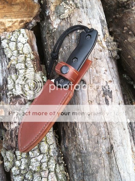

This is after neatsfoot oil and sunlight only on raw leather:
This is after adding some leather conditioner (Montana Pitch Blend):
No dye used.
