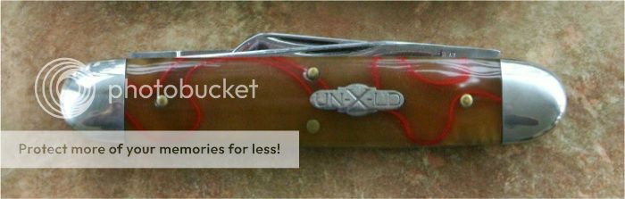

Don't know if these pics will help of the Dixie Stockman, I like carrying it.
See what I mean about those slant bolsters??? Streamlined! :thumbup: But is it a heavy knife?
