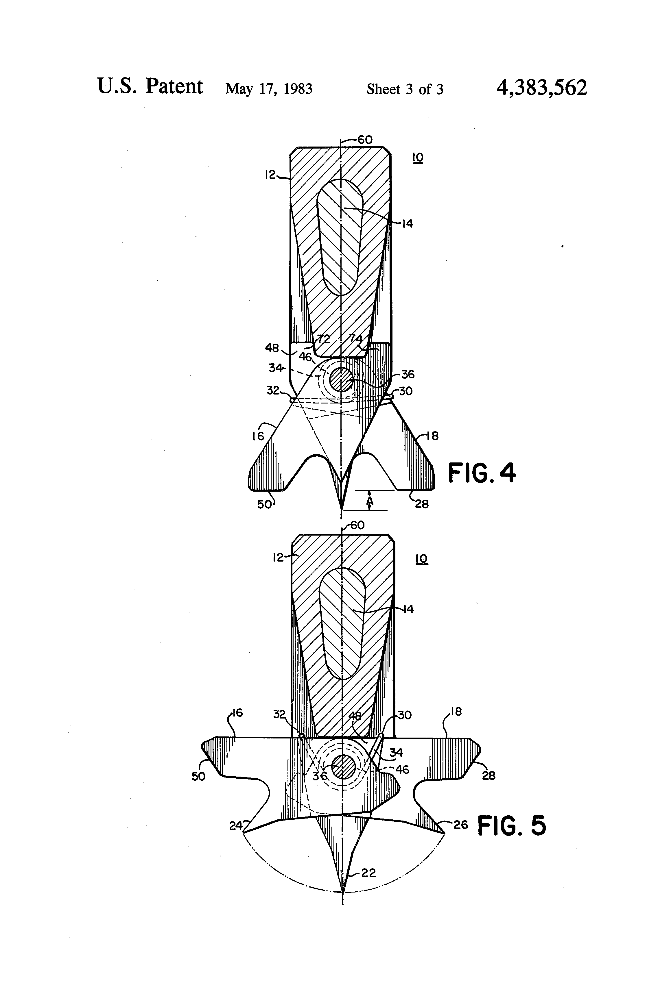

Splitting device
US 4383562 A
Note: The patent date for The Great Divider was in 1983, but the patent application was filed in 1980. The 1981 ads for The Great Divider said "patent pending".

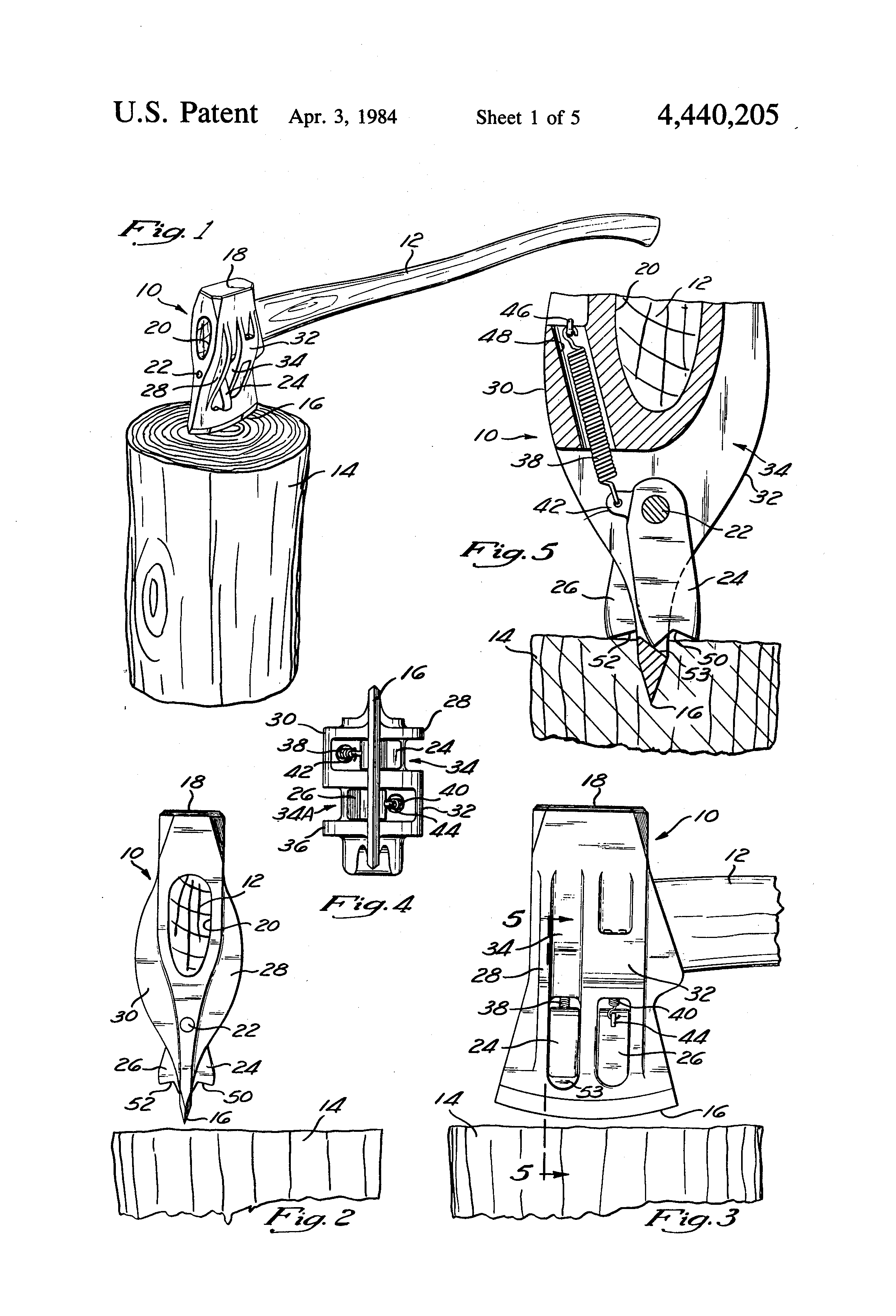

Yet another patent for a splitter with levers. Maybe this is the basis for the double-bit splitter in the first post?
That drawing of "Great Divider" makes me think that my double-bit splitter has very similar flipper/spring assembly, I wonder if this is one of their products?

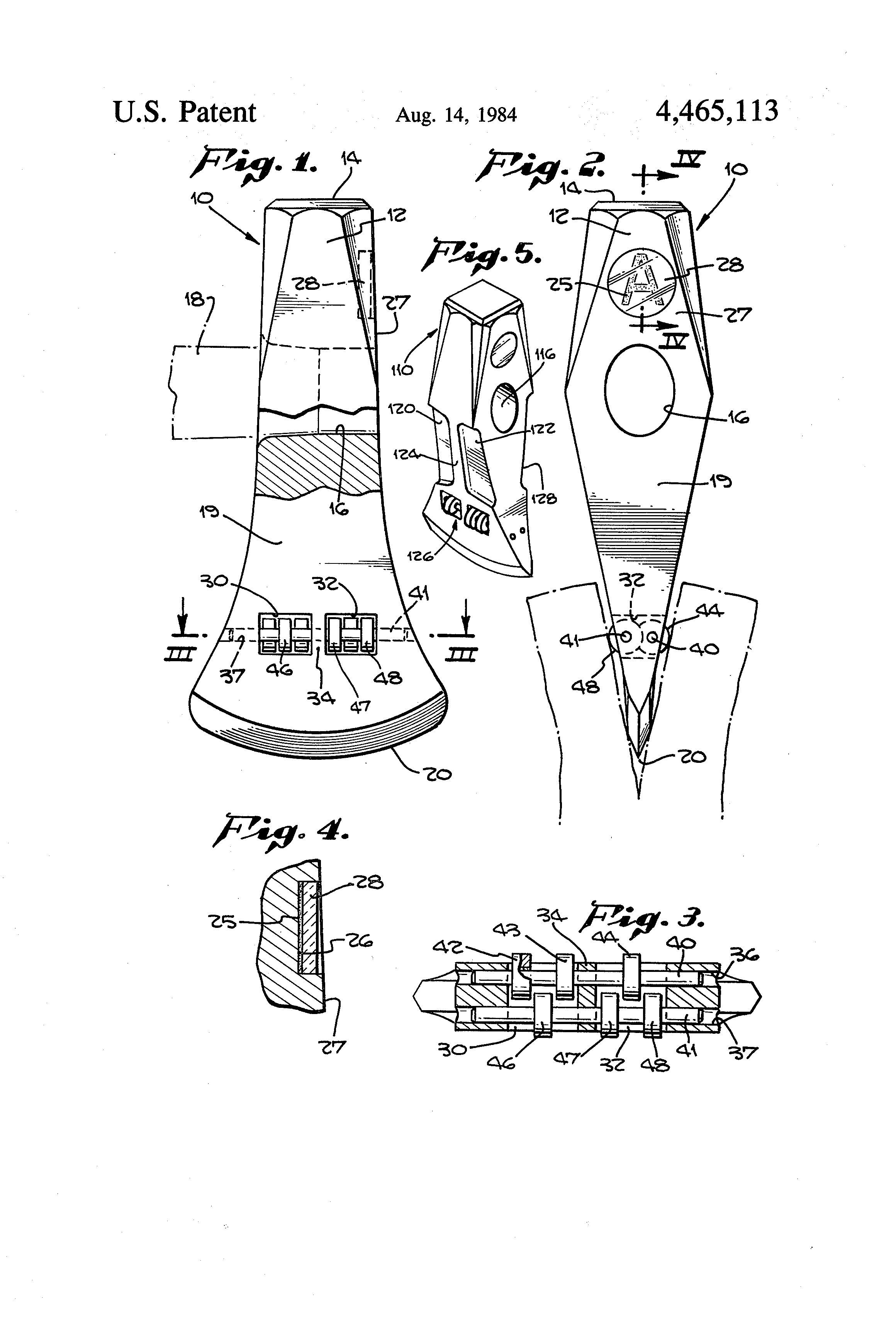

That last patent I posted was assigned to Alltrade Tools.
Alltrade had a trademark for a "Splitmaster" axe.
