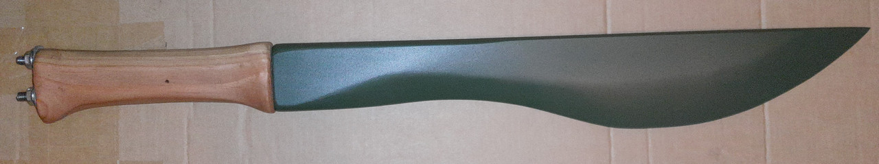

but here's where it's at for now, needs longer threads for the counterweight, but the center of balance is much better now and should be near perfect when it's done.
But the counterweight is only reasonable with the long handle, doesn't change much with the shorter one.
little update

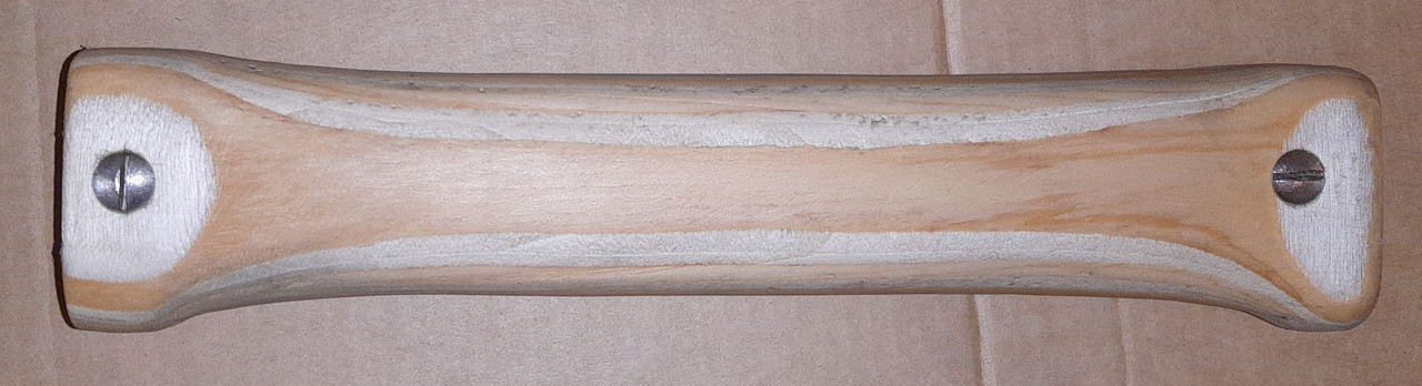

to the surprise of absolutely noone, the layers of the plywood at the core seperated due to bad adhesion
since generally good glue joints are stronger than wood itself I pry the pieces off that still stuck on and glue everything back up
I'm contemplating if I should just try it again after gluing it together or add additional reinforcement
the blade is still way too heavy for one hand, even after removing 500 gramms (1 pound) with files
but I'm not going to remove any more material with filing because it's just not cost effective
however, what little cutting I could do with 2 hands showed good potential
removing more material, grinding a bit of a distal taper and flattening the primary bevel some more (currently it is at about 12-15°) should make this a decent chopper

I will attempt the method with pipes I mentioned previously.
basically, open up the bores in the handle to 8mm, an 8x1mm pipe goes trough the handle and should do the heavy lifting for structural integrity, the handle is just fixed over the pipes with a spacer, I will open up the lead "counterweight" and use that to clamp the handle over the nuts.
I will first try with aluminium, mainly because it's cheaper and easier to work with, but also because the only other option is stainless steel
for some reason they didn't have mild steel pipes in that size and I really dislike working with stainless steel a lot
this is the current construction concept
it feels much stiffer, the pipes can be clamped much harder than the handle
thinking of switching to steel tho
or perhaps shove a steel pipe over the aluminium one, so 8x1mm alu, 10x1mm steel over that
might be good enough

Final update
I pried apart the affected layers and glued them back up as it seemed the wood itself did not fail
Replaced aluminium with steel pipe
upgraded from 4.8 to 8.8 rods
pipes glued in to the long handle to minimize any remaining bending or flexing
added sleeve nuts for added reinforcement
if the handle fails and these rip out at least I know it would help with the next generation

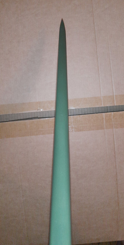

The spine has a slight taper now, 13mm to 9mm from hilt to tip
flattened the primary bevel further, blended the transition
in total about 1Kg[2 pounds] has been removed now
it "could" be wielded with one hand now and "could" be refined some more, but I have to put the project on hold for an extended period of time due to health issues.
currently I have mounted the short handle for storage and beacause it seems to be holding up well
also applied phosphorous coating and anti-corrosion paint as it may be a while
I can not even test it myself until these "issues" are resolved
to the handful of people watching, thanks for your feedback
