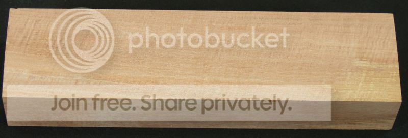

The type of wood I am talking about is California Red Gum Eucalyptus. Here is a photo of a block sanded to 120 grit.

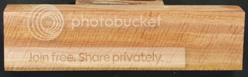

When I sand it to 400 grit and wipe a coat of danish oil the figure shows up a little better.
I know part of the problem is that I can't seem to get a good photograph that is even close to how it looks in person. When I hold a piece in my hand the colors are more of a vivid red/pink and the figure is 3 dimensional with shimmering chatoyance. But when I take a photo it looks bland and dull.
This wood is very hard and sands really nicely. The figure is compact and fairly conservative, but really good. If I show it to someone in person they almost always buy some. But online with my photos, I can hardly give it away.
