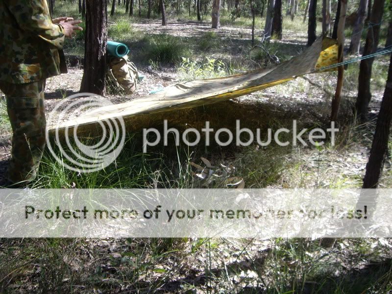

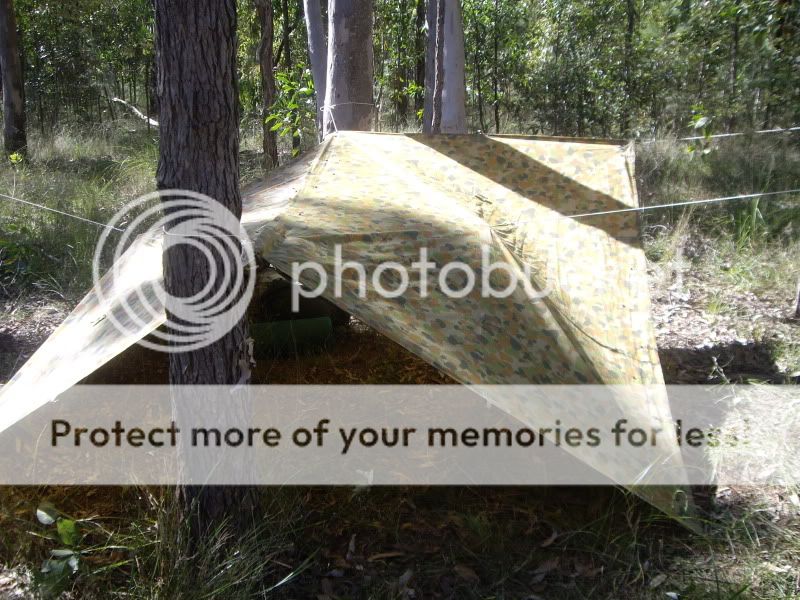

Never used a really big one 'cos I switched out to making my own, but those that I've had that are poncho kinda size are too small for anything other than two methods for me.
1] Foul weather – Classic A shape. Tiny interior but the most weather resistant. Bit of string either end of the apex and 6 pegs. Bungee can replace string if you can get the tension down.
2] Similar to above but with one leg cocked. Just add a bits of string or bungee between the roof and the pegs down one side. Above is so pinched for space I go this way unless the above is really needed. Plus you get more use from your fire / stove access and blah.
These are about the same and as fast as it gets for me. t is really just dependent on finding suitable anchorage either trees or getting the pegs sunk. So the time is really more about where than what config. Swerve that by adding poles or using your walking sticks to go free standing and that'll swing it back the other way.
A couple variations
Carl
