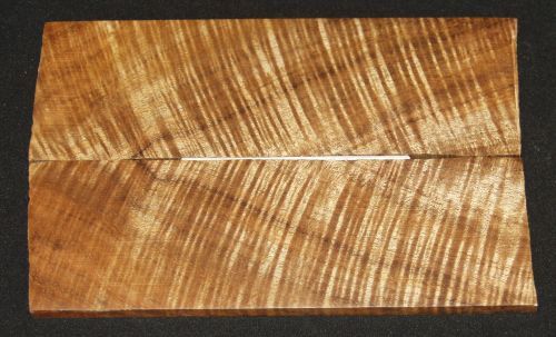

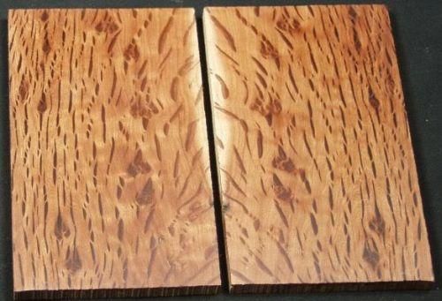

I will start things off with a couple photos of pieces I've really liked.
My very favorite.....Ringed Gidgee.

I think this one was called Hairy Oak

I was gonna say ringed gidgee, too. It's beautiful. Acacia ironwood is another beaut.
Gidgee is one of Australia's desert Acacias. I guess there are a few. What I read on the Australian Knife Makers Guild website says the desert acacias will range from 1.2 to 1.4 in density. About the same as our desert ironwoods.
The red mallee seemed to be real close in density to the gidgee.

The gidgee is definitely my favourite to use for handles. Especially for a handle on a big bowie or something like that. I have also used the Hairy Oak and I really like the pattern that came out on that one. I have used some Mallee Root Burl. Looks great as well. My stepfather used to do a fair bit of wood turning so I get offcuts from the wood turners which are too small for what they want to do but still fine for knife handles.
I recently worked with a bit of red mallee and it is now one of my favorite looking handle materials. I've never seen gidgee in person but I sure like it in that picture.
Belah, ringed Gidgee when the fiddle back is not too tight, Coolabah, Myall. Stabalizing Gidgee is some of the best money you will ever spend, enhances an already perfect timber.

I absolutely love gidgee.... As you already know Mark! :)
I first bought a piece about 11 years ago just because I thought it had a cool name. As soon as I actually put it on a knife and finished it out, I fell in love.
It's got a lot of the characteristics of Ironwood that I love... but it's something different.
Quality ringed Gidgee is like curly Koa (another one of my favorites)... ON STEROIDS! :D
