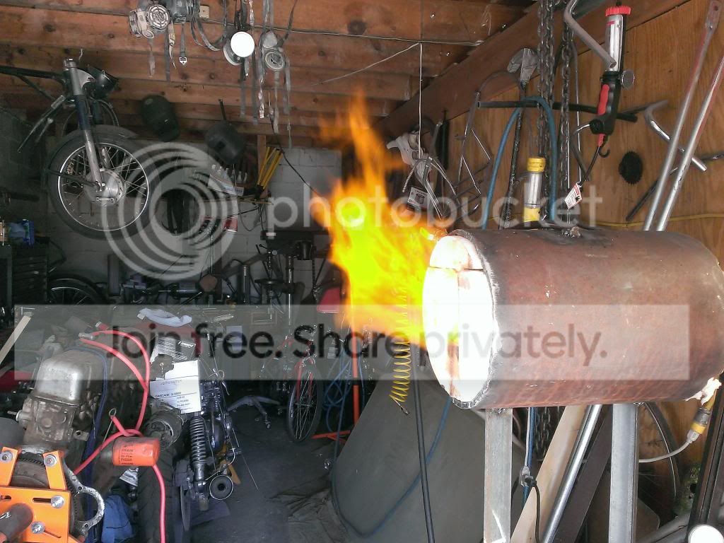

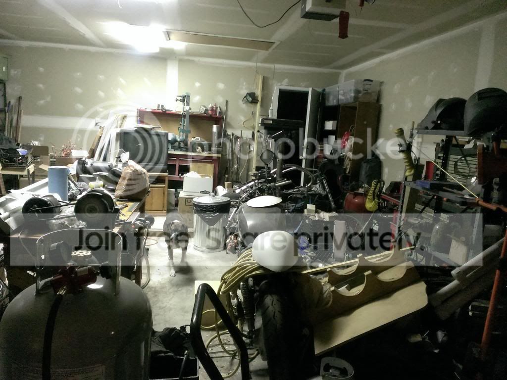

I used to work in the tiny single-car garage of the duplex I lived in. It was cramped, blazing hot or freezing cold by the seasons, all my electricity came from a 100' extension cord that I plugged into my kitchen.
Here it is cleaned out after I moved.
Our new place has a nice two car garage that feels luxurious.
We moved six weeks ago and are still getting settled in so the mess levels look similar.
I've been acquiring tools for almost ten years, I used to work on cars and motorcycles a lot, I do ceramic sculpture and bronze casting along with steel fabrication. A lot of my equipment is low-buck, scrounged from Craigslist or homemade, my forge was almost free because I had squirreled away must of the materials while I worked for a ceramics company. My grizzly 2x72 was the most expensive single told tool I've ever bought. Do as others have recommended: try a kit or other small project first. The investment can be huge.

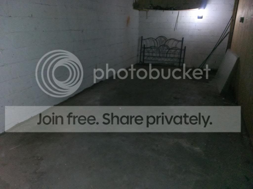

I started in garage.
Now I making my workshop in the basement...
Walls etc... about 25cm of reinforced concrete :P ( Bunker :P )
Maybe sometime I'll make photos of my shop ;) ( when will be 100% ready :P )
