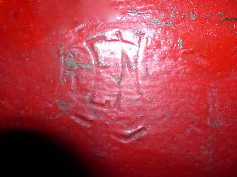

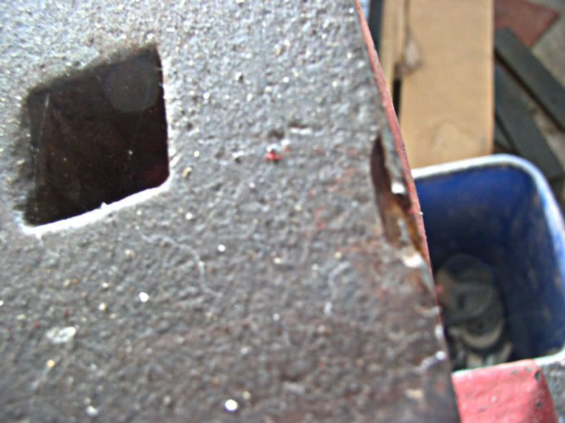

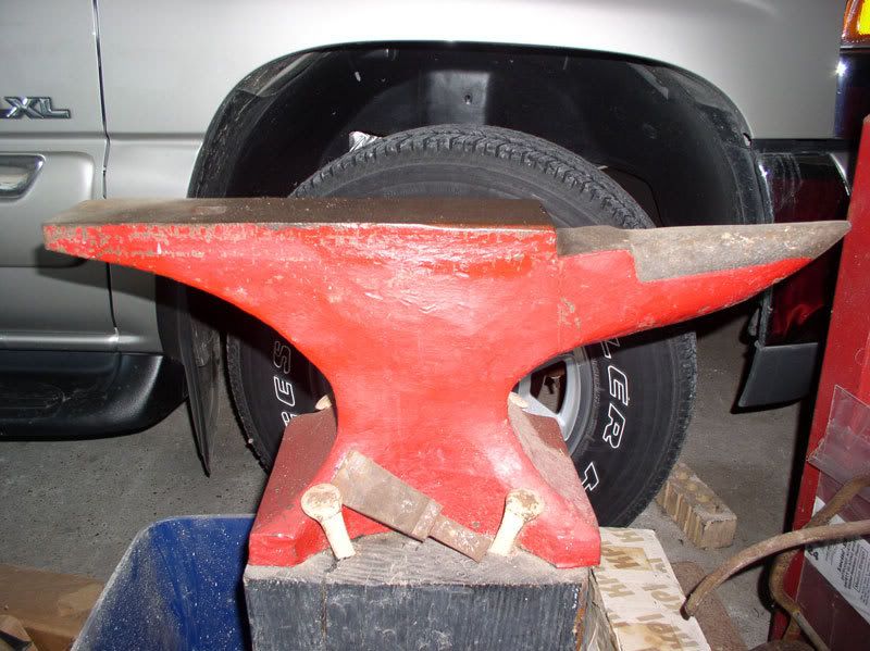

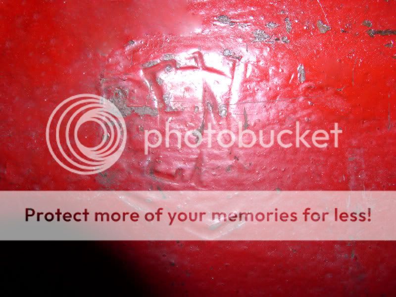

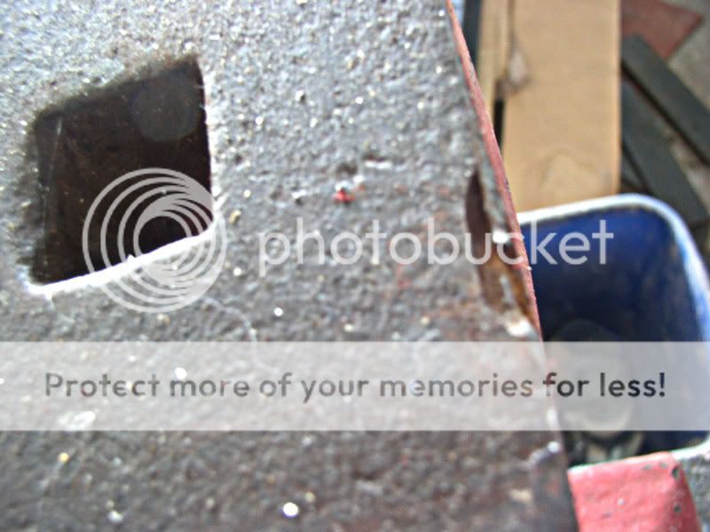

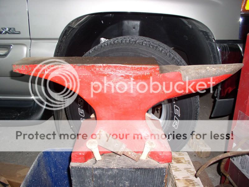

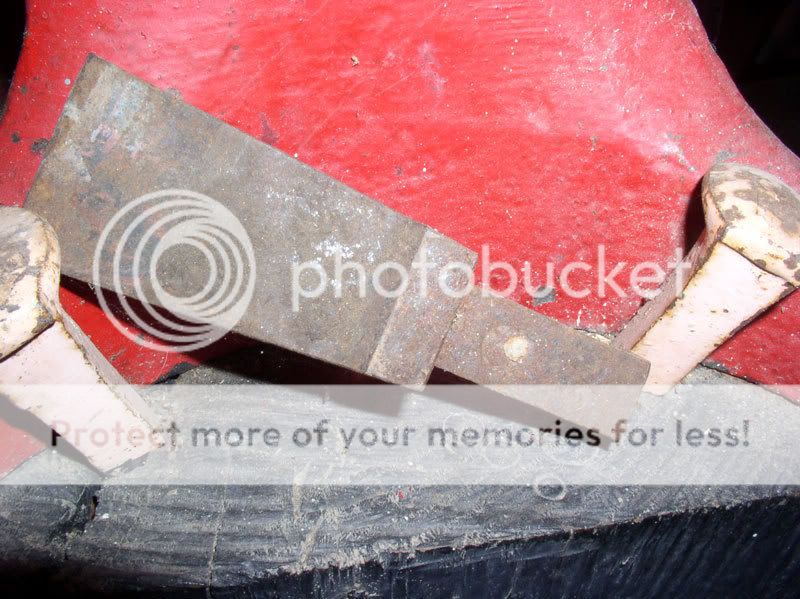

What kind of anvil is this?
Dec 1, 2006
58
I found this in my grandfathers garage, and i may be able to acquire it.
I took a long look at it and cant find any other marking on it besides the one of the side. Don't even know how heavy it is.
Yes, it is a Trenton. If you remove some of the paint a weight should appear on the body. They are American made and have the weight stamped on in 100, 125 etc. lbs. not the English hundred weight system. The Trentons are usually larger for their weight than many other anivls due to the small waste and lighter base. They are usually very good anvils. I can provide more info when I can get to my reference books.
Am I going to have any trouble with that little chip on the edge? Should I just leave it alone?
It is not uncommon to find chips like that in an anvil. It should not affect the anvils performance.
